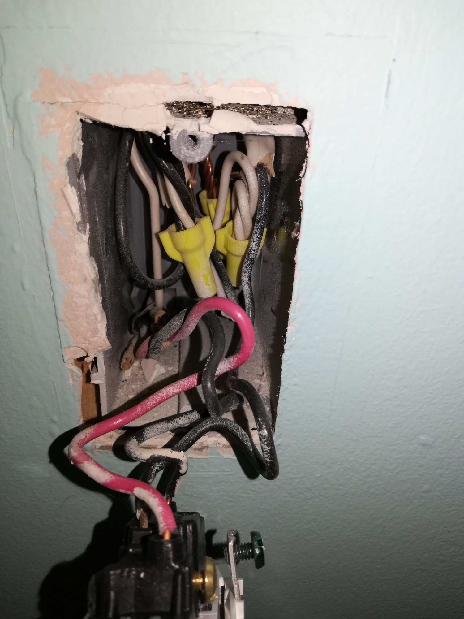

I was replacing a 3 way switch and thought I would not need to mark the wires because it would take just a minute. Yeah, correct. Got the switch off and the door bell rang. Stupid me. Now I have a brain freeze and cannot figure it out because the switch has a white wire instead of black.
Anyone who can figure it out?
