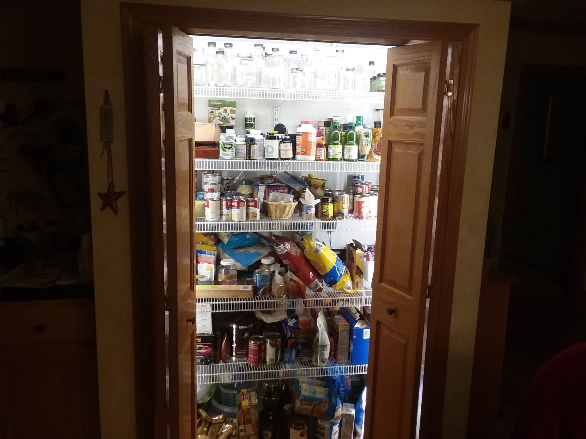

I have installed LED strip lights around a door frame in our pantry that is switched by a magnetic switch on the door. All that is needed is a receptacle for the wall wart.

You can use bulbs that operate from 120 vac or 12 vdc. Your home electrical system most likely has components that are UL approved and connected to meet National Electrical Code requirements. All components have primary voltage of 120/240 vac. For 120 vac bulbs, just add the components rated for 120 vac and connect them to existing electrical system. To use a 12 vdc bulb, you need to engineer another electrical system. You need a 120 vac to 12 vdc converter with a wattage rating exceeding the 12 vdc bulb rating times number of bulbs. You need to determine where to place the converter between the breaker panel and the closet and size the wires for 120 vac and 12 vdc appropriately. I would also fuse the 12 vdc source.
I prefer line voltage (120VAC) fixtures. In end it really doesn't matter because the LED is powered the same. The difference is a separate power supply and wiring... more complex. I like having the power supply as part of the fixture. With a 12 VDC system there needs to be a separate power supply to feed the fixture and I don't like the idea of using two things when one can do the job.
I'd definitely go for a 120v fixture. Unless there's a good reason to go 12v, it'll give you more options in terms of fixtures and future replacements.
