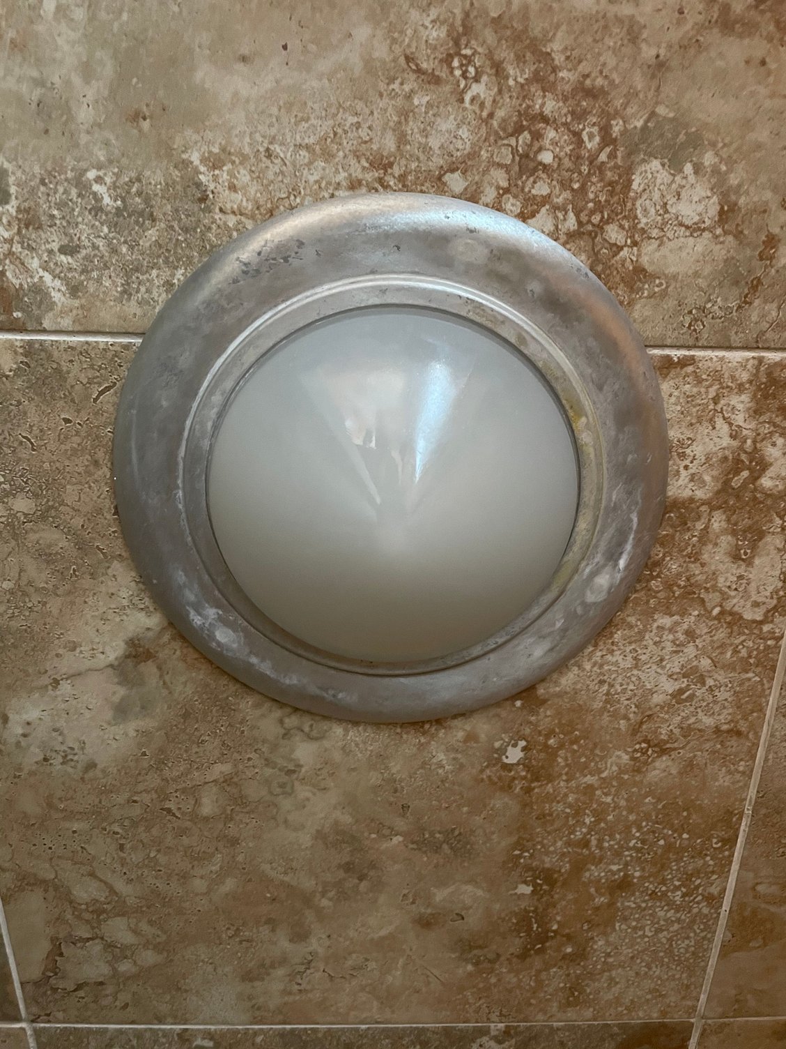

Any tips on how to unscrew and replace a dome shower light like this? The glass bulb part moves but the metal ring does not!
Thanks for any tips!

The ring and dome will pull straight down. There will be hanging wires on two sides.
This video should be what you have. There are more videos on the right side of that video.
Recessed light lens removal

Thank you for the advice! Itís a little hard to pull down with fingers. Planning to use a screw driver to push it down. Is that ok?

Yes.... use anything to allow you to get your fingers under the cover.
Once started it will pull down easily.

Thank you! It worked and we successfully replaced the bulb. 💡 😊
