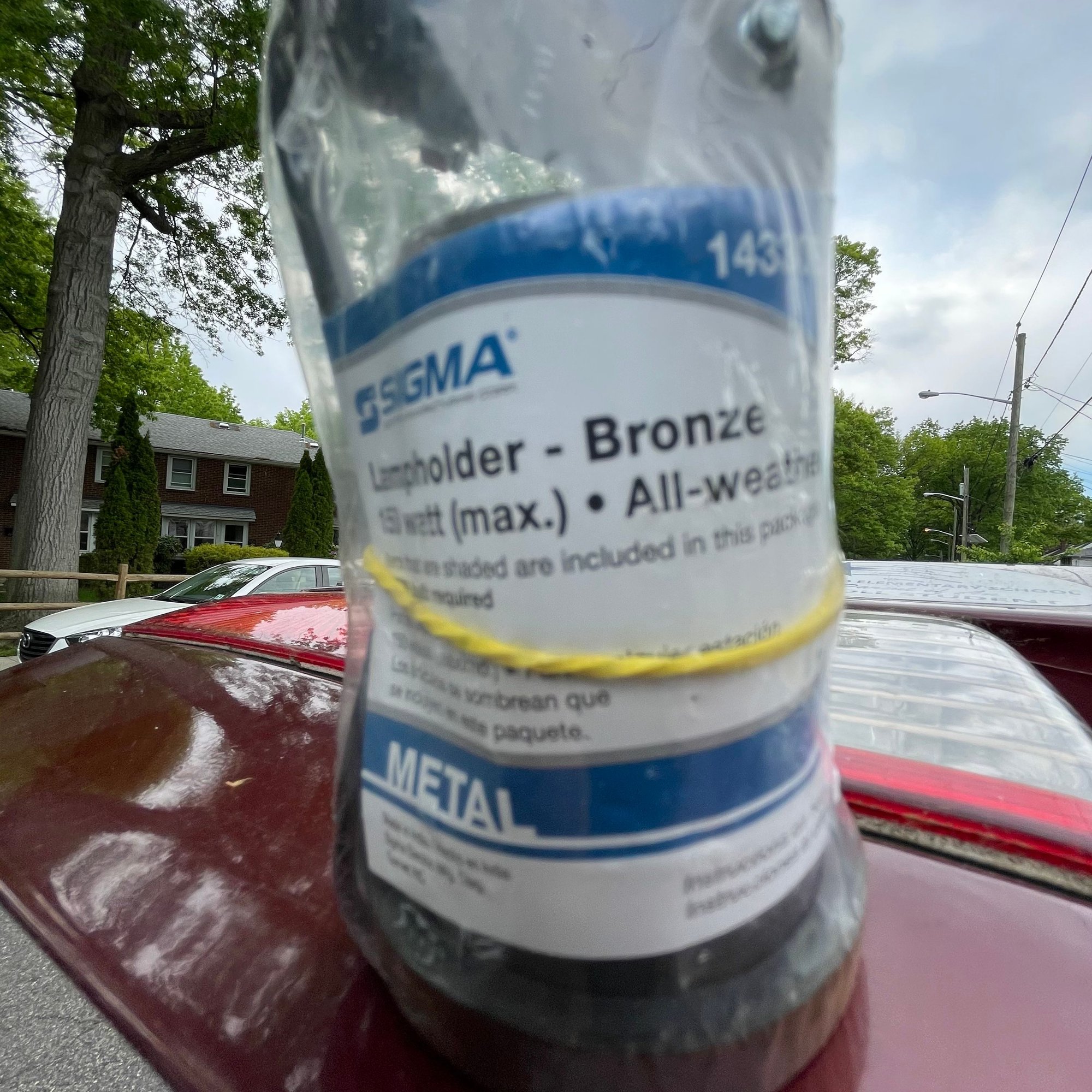

am installing multiple lamp holders for my garden bed to use par 38 flood light bulbs. I purchased all weatherproof materials that is rated for outdoors ( dug trench, purchased uf 12/3)
The power source is coming from the garage right to the lights, then after the last light will be the switch inside the bar. What would be the correct way to connect all of these lights to the one switch? Also want to put an outlet and another light inside bar. I’ve attached a diagram for better understanding

Since you are using three wire everywhere.....
the black will be always live and just carried thru every light.
Each light will connect to the white neutral wire.
Each light will connect to the red wire which will be the switched hot.
At the switch end.... the switch goes from black to red.
Since you have always live power at the switch you can connect your receptacles to the black and white wires.
All ground wires are interconnected.

You will have a red and white splice to connect the light to in every box. If the light socket wires are too short to reach the splices then you'll need pigtails from the sockets.
