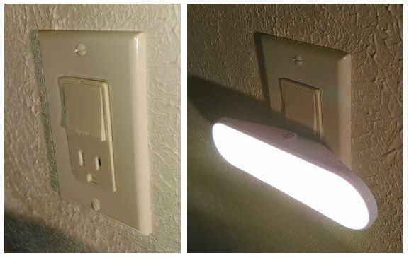

FYI, I had a talk with Leviton's tech support and the 5645 will not do what I want. The default configuration is for the outlet to be "always on", and I would apparently need to run additional wire to make it a hot switch. Eaton's offering would work, but isn't available in a Decora design. Cooper is out, too. I forget the reason. I am now trying a Legrand combo switch and will post more when it arrives.
Old 10-23-21, 10:30 PM
T
Join Date: Oct 2010
Posts: 17
Received 0 Upvotes on 0 Posts
A final followup. The Legrand combo switch did the job:
The stock installation turns the family room light on, as well as the outlet, which when populated with a bright night light also illuminates the top of the stairs. The night light has an optional light sensor with an On-Auto-Off switch, but I leave it at On. If I don't want/need more illumination, I can just remove the light and the switch largely degrades to its old function. The "magic" I alluded to earlier is just getting a switch that does what you need out-of-the-box. Some operate the outlet like a hot switch by default, and some expect a different source of power. Actually, I believe the Legrand easily does both.
My only complaints are that I couldn't find a lower profile light, as it gets in the way of the switch somewhat. And that the purchase had to be a special order. Hopefully this helps someone else doing a web search.
