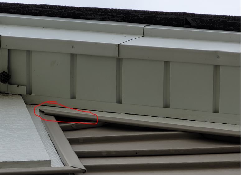

Thanks for the response PJmax! I was able to get some pictures of different angles of the house. Is it difficult to get behind the rake board? I haven't worked with any soffit or fascia material before. I did circle an area in red, I was eyeing up and thinking maybe I could put the wire in or under that area and out of sight. For the wires, I'm assuming I will have to buy a few extension wires that plug into each other to extend the wires to meet at a central point. Then plug into the outlet.
The other question would be at the garage the rear gable, what would I do with the wire when it gets to the bottom roof area near the gutter?

I was able to find a picture I took of my house under construction. I put some arrows of what I am now considering. Is taking the wire at the Gable at the main entrance under the rake board/J Channel, etc to under the soffit area near the garage (assuming there is an area under there I can get into the garage) and bring it to inside the garage from there (without too much trouble/effort) and then take the wires at the garage area straight into the garage via a drilled hole, and then meet up the wires in the garage attic a good plan?
When in the garage attic, can they just drape over and be anchored to the bottom part of the engineered trusses?
In your last picture the two locations back to back with the attic over the garage are easy to work with. The higher location doesn't have as clear a shot.
Very easy to push the wire in the back where the red line is. Behind the trim/J moldings (purple) is good too.
