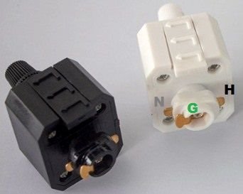

Check power at the feed end first. If there is power at the track then check to make sure the heads are correct. There are three types of track. H (Halo), J (Juno), and L (Lightolier) make sure your heads are correct for the track you have.

Compare the track connector of your old fixtures to the new.
If they are track type H. That is Halo and others like Hampton Bay. It will have three visible pins.
Also make sure they are installed in the correct orientation. They can be forced in backwards.

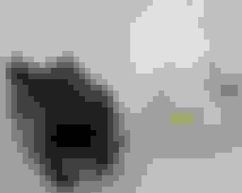

I know that problem well..... you lost the connection between the track and the starter end where the wire connects. Double check the starter is fully inserted into the track.
When you disconnect all the fixtures and then start reattaching them.... the copper bus bars that the heads connect to can slide and sometimes one will slide away from the starter end. If a bus bar has slid you can see it at the end cap opposite from the starter end. Many times I've had to remove the heads and slightly tap the end of the bar with a screwdriver and hammer towards the starter end.
Copper bus bars. In picture they are excessively slid out of the track.
