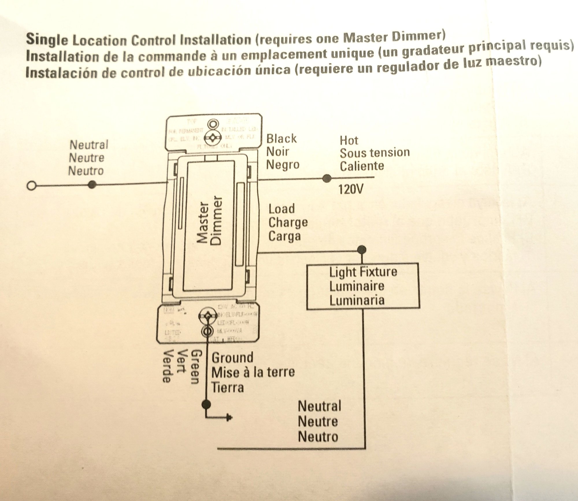

Thanks Pete. Here are the wiring diagrams for the new smart dimmers and smart switch as well as photos of the other standard 3 way switch in our living room.
I'm trying to avoid unpacking every bundle in the 3 gang box if possible because it is very packed and 12 ga doesn't like to bend. As far as the black wires go: "C" black is to bottom of old 3 way switch. "D" & "E" black is going to the nut with what appears to be the hot black to the bottom of left fan switch, loops on to bottom of current dimmer. "A" black is to top of left fan switch and "B" black is to the other bottom screw of right 3 way switch. The other thing throwing me off is that the black wires from bottom of fan switch & dimmer as well as "D" & "E" black are nutted together with the white from "B".

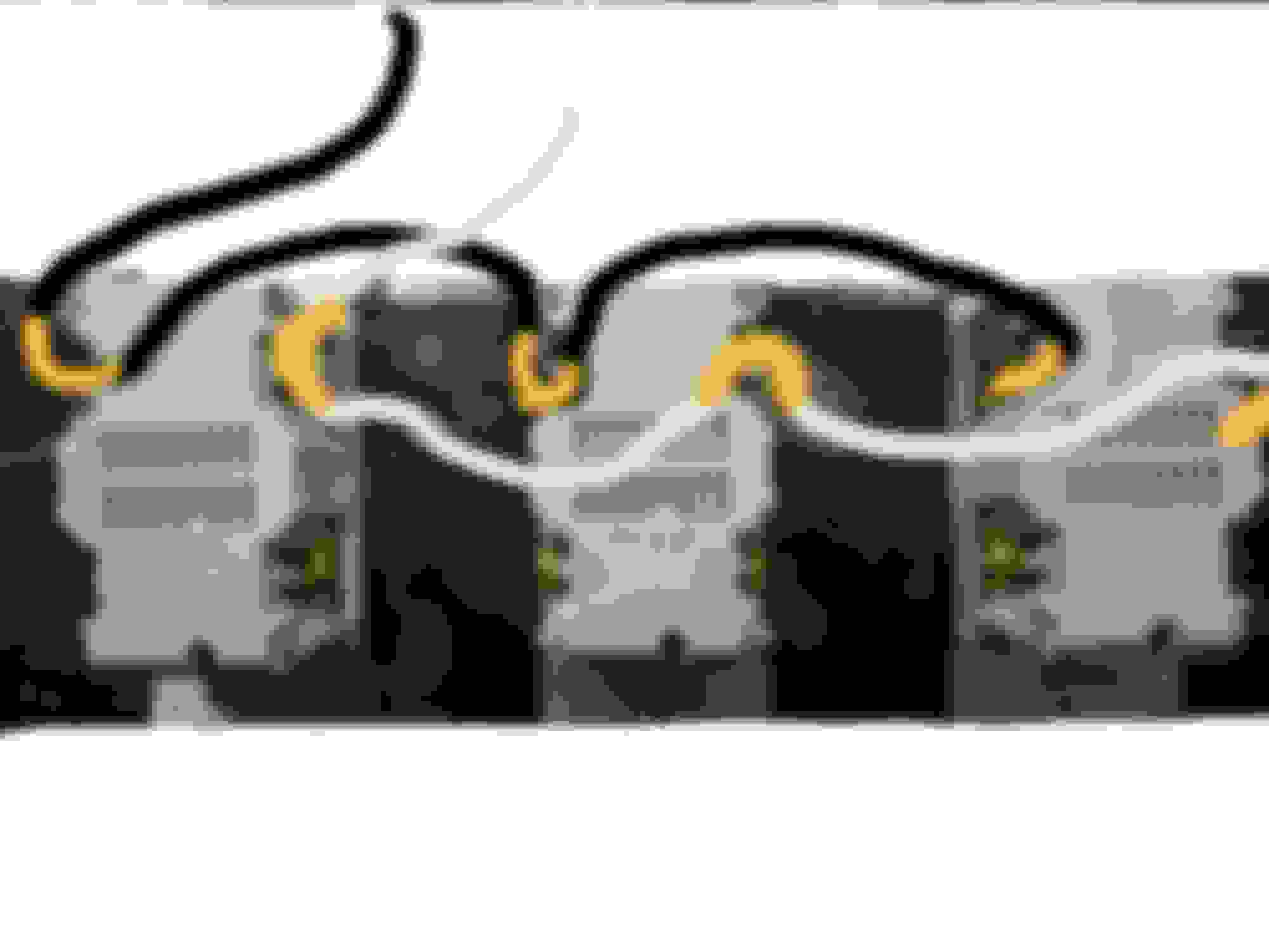

Also, this is just a quick drawing of the current box that I made to try and visually unpack everything (I'm a visual person, but embarrassed at the terrible drawing that was made against the wall)

Cable B goes to the other three way switch. You will need to connect that white wire (B- white) to neutral. You will need to cap off B- black wire. B- red will be the traveler. At the far end switch.... remove and cap the black wire. That will leave white on common terminal and red on a traveler terminal.
Since you will have four additional neutrals..... it would make sense to make them a splice and a jumper to the white neutral splice in the box. All three switches share the same hot.

Thanks so much Pete. I'm still trying to understand why they had the "B" white spliced with the hot black from the circuit line D & E??? Also, do you know if there is any reason I can't use the smart dimmer for the fan speed control?
Also is it possible to do a looping wire through each switch's hot and neutral screws similar to the way they previously did the hot black to the fan switch and dimmer? Or is that a big NoNo?

With a three way circuit.... one switch has the hot/line on the common terminal and the load/light is on the other switch common. Power was sent to the remote three switch on white. It returned to the close three way switch on red and black travelers. The light was connected to the common of the shown switch.
If the dimmer lists fans in what it controls then it should be fine.

Those screw terminals are approved for two wires.
So instead of looping the wires.... use short pieces of wire between them.
