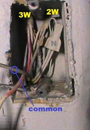

installing a dimmer
How can I install this dimmer in place of the switch on the picture? ty

Is there a pair of white wires connected with a wire nut inside the box that we cannot see? If not, and if the three wires connected to the switch are from the same cable, you cannot use that dimmer to replace the switch.

There is a pair of white wires connected with a wire nut inside the box.

The switch appears to be a 3-way with a Line or Load wire (black) on the common terminal and 2 travelers (red and black). The dimmer appears to be a single-pole (1-way) with connections for Line (black), Neutral (white), Load (red), and Ground (green). That is not the correct dimmer for 3-way switching.

I think u missed something there,this is for single and 3way,it has that red with white line on it too.
It looks like (since I am changing one of the switches to dimmer),from dimmer switch to the existing switch Red&white wire goes with red ,common with black ,green to ground and red to traveller black.Could you guys tell me if I am right?

Sorry, I did not see it as red. I thought it was white. Now I see it. I looked up the wiring diagram to be sure. That dimmer does not require a neutral but it must be installed at the Load end of the circuit (the single black wire goes to the light.
In that case the single black wire at the top of the existing switch should be connected to black on the dimmer. The other two wires on the original switch connect red to black traveler and red stripe to red traveler. Green is connected to ground wire or to metal box.

If what 2john posted doesn't work..... check the unconnected black wire coming out of the two wire cable.
I labeled it as common. It must be always live for the dimmer to work there.

I did check ,it was written on the back by the wire COMMON,I wired them and it worked great.Thank you all for teaching me this,I talk you all on next new threat soon.
