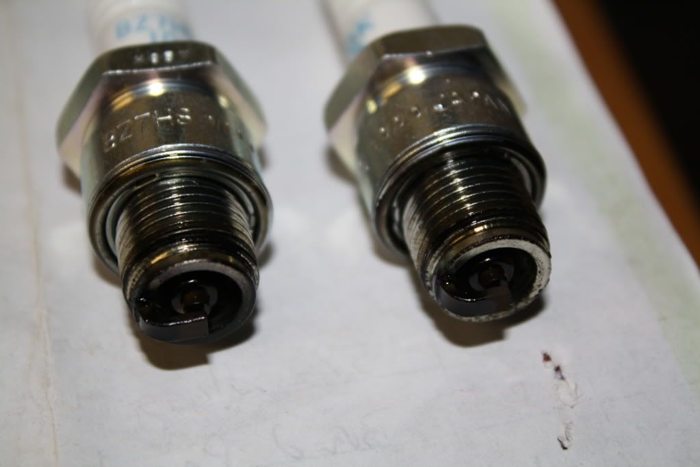

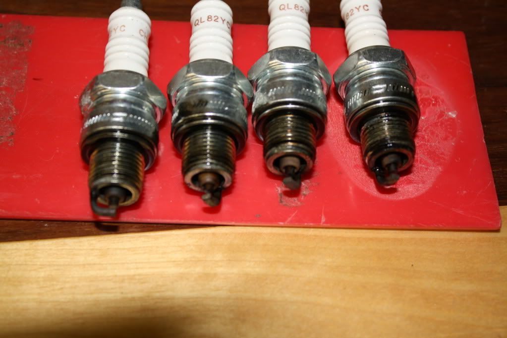

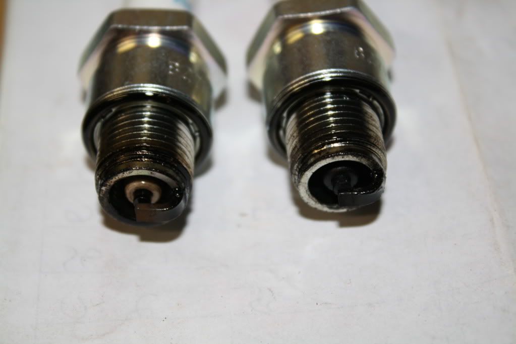

I have a '94 Johnson 120 (J120TLARK) with a few.. annoyances. First, It's got a backfire at low throttle speeds.. (idle - 2000rpms or so) Usually, after it is warmed up and has ran WOT (or just under) it doesnt do it as much. After running no-wake speeds for awhile, it will start backfiring (and loading up). It doesnt do it constantly, and after planing back out it will clean out and run up just fine. I put a new set of NGK BZHS-10 plugs in it gapped at .035" and this is what they look like:
Port side (cyl 2 & 4)
Stbd side (cyl 1 & 3)
I've been told this is somewhat normal for the "loopers" but it seems excessive to me, and I am a tad leary of doing any carb. adjustments without all of the proper tools. I did check the timing, which is supposed to be 6*ATDC and ended up being 9-10* ATDC I think.

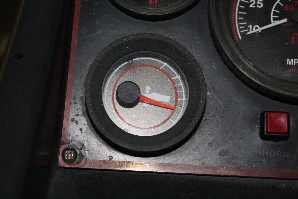

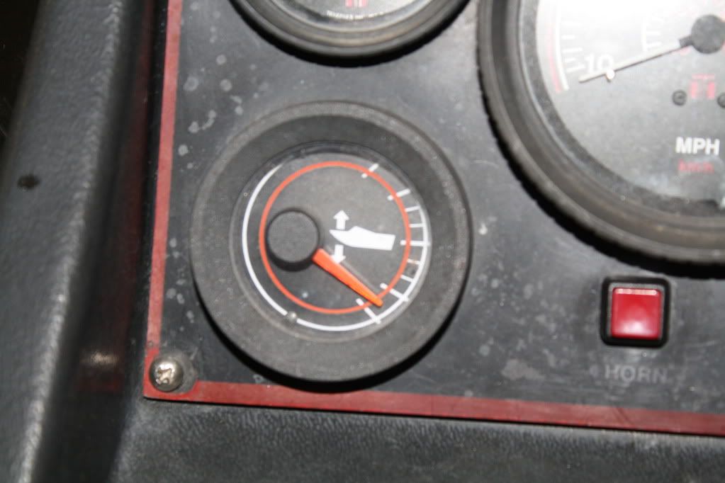

Second, Is this normal? Ever since I got this boat, The transom was a little saggy (rotted. )and thus having to trim the engine all the way up to get max speed . I have since replaced the transom and no longer have the sag, but can't trim it up very much before it loses its bite.. here's where I put it to get on plane:
And this is about as high as I can go now.
In the Top picture, I can go down a little bit more from there and the highest the engine will go is the second tick mark above the middle of the gauge. (while above 3000rpms - safety feature I think...?) I'm guessing its normal, I am just not used to the engine being where its supposed to be on a straight transom.. I'm using a 13 7/8" x 19P SST prop. WOT is about 5800rpm.

Without knowing how the Johnson carb is set up, it sure looks like heavy flooding. If the carb has a float, that is where I would check first. Either the float has absorbed fuel or the float valve is sticking.

Well, based on information I've gotten from other people, the VRO is a little oil happy but that shouldn't cause it to backfire. It does smoke a bit when you start it up, but once you run it and warm it up, that goes away for the most part. I know the high-speed mixture is metered by a jet and the low-speed mixture has an adjustment screw.. I thought about leaning the idle mix down a little bit.. would that help?
The carbs were rebuilt 2 years ago and has been stored over winter with Sta-bil and Seafoam in the gas since I bought the boat 3 years ago.

I mistyped the timing - it is supposed to be 18* BTDC according to the sticker on the air box. When I checked the timing last, it was a few degrees less.. 15 or 16*. My memory is a little fuzzy, but I went and looked at it to verify.
Also, I checked the pulse limiter fitting and cleaned it out with carb spray per the shop manual. Is that pulse limiter supposed to be free flowing from both sides of the fitting? Mine allows air to pass from either side of fitting. I looked inside the fitting hole on the engine and I saw no carbon build up, so it appears to be working properly. I'm guessing the backfire has to be ignition related and there's something amiss with the fuel system causing the rich condition.. Anyone have any thoughts?

What hole is the motor mounted on? can it be lowered 1 hole? This should help with getting on plane. 5800 rpm's is about perfect for top rpm.

The pix of the plugs look like oil fouling from too much oil in the mix. That could cause the symptoms you're seeing, including the pre ignition and cool running.

Those plugs have already been changed out (BZ7HS-10). I do not have current pictures of the plugs I have in it now (QL82YC's). I am going to work on the engine tomorrow, I'll take pics of the plugs and post them. I am waiting for 2 new thermostat diaphragms which should cure the cool running temps, and I am going to troubleshoot the fuel system (again). I was looking at the VRO troubleshooting flow chart and it refers to a gearcase pressure tester and a gearcase vacuum tester to test the functionality of the VRO pump. Where the heck can I get something like this without having to order it and wait a week to get it? It says to first put 15psi pressure to the pump, check for pump clicks, then put 15" vacuum and check the other side of the pump. I have a manual vacuum pump, and a vacuum/fuel pressure gauge for automotive stuff but no pressure gauge.

Point is, though, that new plugs will foul in short order unless the problem is corrected.

95% improvement on almost everything I had issues with... Except this odd miss.. I don't think its a miss as its very sporadic and not predictable and only happens at WOT. When it does this "thing", the boat jerks once (like hitting a small log) and keeps going as if it never happened. I changed the gear lube (only had about 5-6hrs on it since I changed the lube after break-in of the new gearcase) The magnetic plugs had some shavings on them, well more like dust soaked with oil. I used Amsoil synthetic marine gear lube when I refilled.
After the new fuel pump, the engine starts cold a heck of a lot easier, idles better, doesnt smoke to oblivion and doesnt missfire/backfire nearly as much. (still getting a little bit but its pretty minor now.) Johnson Engine Tuner cleaned it out a little better, still have carbon on the pistons though.. (light) Here's my plugs as of the other day.
I've never had dry brown plugs in this engine. (I'm wiser now...) This engine has always had black oily plugs since I've owned it.. Everyone told me "Its getting plenty of oil, so you know its lubed good - don't mess with it".. They're full of it. This thing runs awesome now.. I just wish it went faster.. By having the engine run better, its about 3mph slower than it was in near-identical circumstances.
