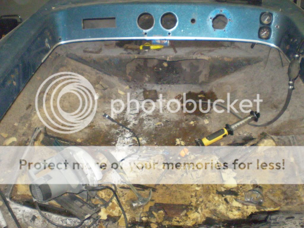

This is it on the day I brought it home.

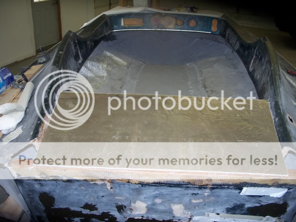

These boats have a bulsa wood core that all had to come out.
I made my own vacuum pump to suck the bulsa down so there is no air under it, this is all the new bulsa in.
I cut the splashwell out in order to replace the transom so I made this flat panel instead or putting the splashwell back in.

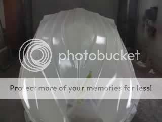

The gel coat was so cracked up I got the bright idea to sand it all off and repaint with interlux epoxy, I had about 100 hours in this alone.

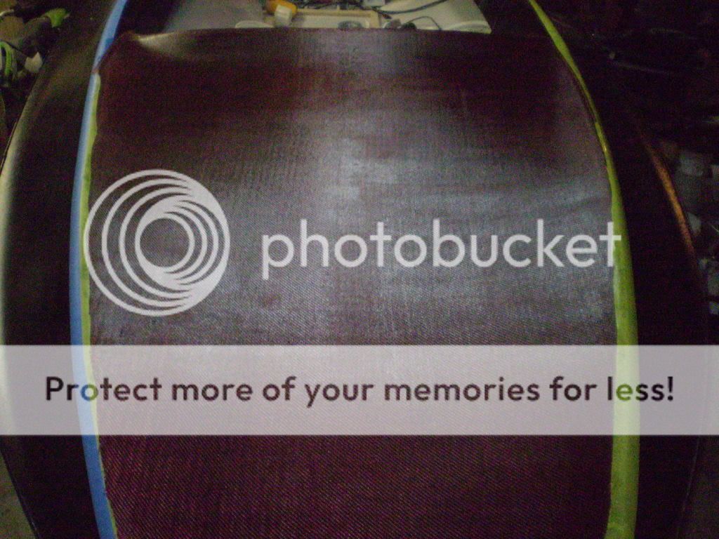

This is going to be set up as a drag race boat with center steering so I filled in all the holes in the dash. At this point I vividly remember all the sanding I did on the bottom so I figured I would try something unique and bought some carbon fiber for the top. I first gel coated it black then started to lay out the carbon.

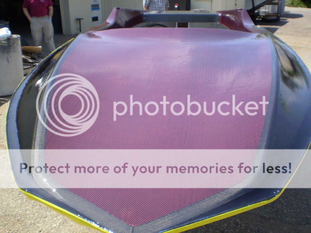

I used three colors of carbon to break up the body lines. There was still a lot of sanding but after getting some clear gel coat on it this weekend it was well worth it.
This will be powered by a 2.4 liter mariner 200 with a 130 hp nitrous kit from nitrox and will be raced in a 95mph class.

Dumb question: Wouldn't the ripples of the carbon fiber create drag?
Nevermind. I read your posting the I did it myself section and found the fiber is on the top of the hull.

Like you said it's just on the top, and with the clear gel coat being so thick I will be sanding it to a smooth mirror finish.
