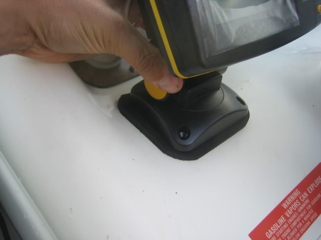

I need some help.
I just recently bought a used Sea Ray 195 that used to have a fish finder installed on it. The old head unit was removed and the holes where it was mounted were "covered" by threading bolts through with grommets to make the hole pattern look less painful to the eye.
The mount point is the most convenient (but still not great) spot on the drivers dash. If I could mount the finder somewhere else, I would.
Here's the problem...I bought a new finder, and the base is not as large as the old one, and the mount points don't quite match the existing holes. I'm thinking of "solving" the problem by using 3 of the existing holes, then elongating the 4th so I can get the bolts through, using washers to bot against (since the holes will now be too big for the bolts to do the trick). Then, to cover the cosmetic problems this process will cause, I'm planning on cutting a black mouse pad to be slightly larger than the base of the finder mount I have and using that as a black "rubberized" base (the finder is black). This hopefully will cover the cosmetic mess, and helps secure the finder as the mounting area isn't flat currently, making tightening down the hard plastic mount that much harder.

You have many options.
One is if the holes are close to the new finder's you could enlarge all the holes in increments of a drill bit size.
If the holes are close you would find that they will eventually line up.
The deciding factor for this is the actual spacing difference.
Another way is rather than use a mouse pad go to a plastics fabricator and get a piece of some type of complementary color and type of plastic as a new base.
How about wood?
Get a piece of solid oak and have it planed to 3/8" thickness then router the edges, apply a clear weatherproof finish and mount the finder.

I thought of the wood or plastic mount piece as well, the only issue though is connecting it to the dash. I'd need to glue it since the new mount holes are close enough to the old holes that I can't just bolt it in place. Otherwise, an excellent idea.

True...actually, I'm pretty good at fearlessly drilling holes, although drilling into fiberglass and gel coat has me freaking out a bit since a bad drilled hole isn't easy to fix.
Okay, I cut the mouse pad and fit it, and it looks like it should work and actually looks the part. Pics attached. The fuzzy one is supposed to show how the holes, without the mouse pad, are slightly past the mounting base.
Wish me luck, tomorrow new holes get drilled.

When you drill through gel into fiberglass use the bit in reverse until your through the gel then go forward. You will be less likely to chip the gel. And make sure you champfer the holes so the screws won't touch the gel that way you don't have to worry about cracks in the future.

Well, I'm here to post the post-install report. I'm happy to say my mouse-pad modification worked as promised and it seems at least for now to look good and is doing the job. I managed to get the transponder on and everything wired (directly to the battery with an inline fuse). Right now, it's just a matter of letting the 3M 5200 set, then float the boat again and see if the transponder properly transponds.
