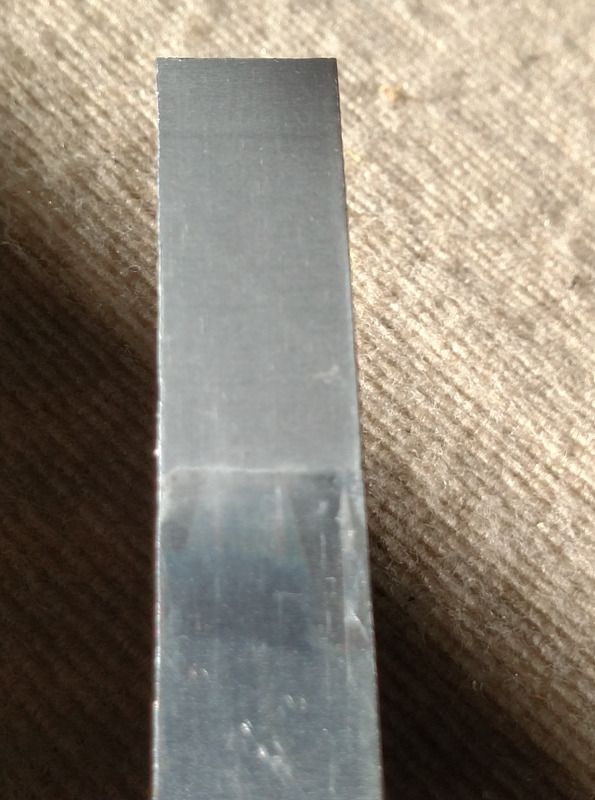

Here is aluminum after 5 minutes soaking in Purple Power (a base) cleaner. At the bottom you can see the shiny untreated aluminum and at the top is the haze caused by the etching. I'm hoping this alloy turns black like yours or I'll have to try a different piece.

I have no trouble working with Alumiprep though I do wear rubber gloves. You obviously need to be careful not to splash it in your eyes but it's not strong enough to smoke or emit vapors that cause irritation. It is no where near as nasty as Muriatic (hydrochloric) acid.
70 minutes in and my first piece of aluminum is still silver though etched more. I'm throwing in other alloys to see if I can get one of them to blacken.

I didn't have any cast aluminum but I did end up soaking three different alloys. One showed pretty severe pitting after three hours while the other two were in much better shape.
I would stop trying to go for a "color". Anything and everything you do to those castings is removing metal. I'd give the bearing mounting surfaces a light buffing with a Scotch Brite pad then install the bearings to make sure they fit nice and snug. If they fit tight then I'd clean up mating/gasket surfaces and put the thing together. If the bearings are a bit loose you'll have to decide if you want to Loctite them in or trash the case.
