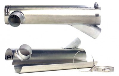

Cushman Manifold Heater
Pete, the neighbors are impressed with the new Canopy and Enclosure, and have asked when I will add heater and air conditioning. It seemed to me that at one time Cushman actually made a manifold heater kit for the 18 hp twin aircooled engines used in mail carrier and police vehicles. I cannot find even a photo of that accessory, but have seen some kits at Summit racing. I know that AC will take too much power and room for my Golfster, but a heater might be an impressive option at the shows! How does a manifold heater safely pull the heat from the manifold itself?

You can look into experimental aircraft suppliers. There are heater shrouds that you clamp over an exhaust pipe or you can make your own then all you'd need is a blower.

From the look of your example, all I would need is access to a straight run of OEM exhaust pipe so the kit or home made shroud could wrap around it. cold air enters from the left and warm air heads for the cab via a hose and blower on the right?

Air can go in either end. If you don't have a long enough straight section of exhaust you can make up or buy two shorter heat mufflers. To extract more heat you can stretch out a spring and wrap around the exhaust pipe before you clamp the heat muff over the outside. If you are creative you can make one that will fit over curved sections of exhaust.
