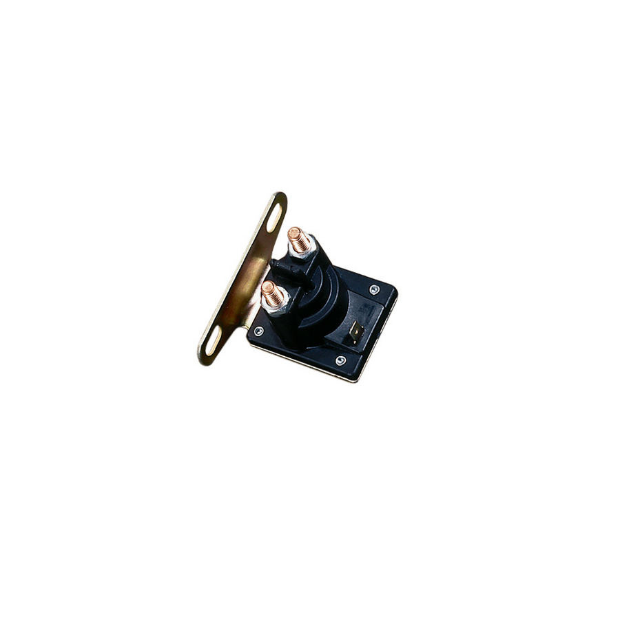

Alright, the first one is when I turn the key over the lawnmower used to make a clicking noise but now it does nothing. It just recently had a new switch put in. When you turn the key on to run, and cross the solenoid over, it fires right up. That means the solenoid is bad, right? I was wondering if I could buy this solenoid
and mount it somewhere else for easy access? It is an mtd but it should fit if it can be mounted right.

Alright, my friend that gave me the lawnmower came to town and we got to talking about the lawnmower and went out looking for him a new one but we had no luck. His dad is pretty picky about what he wants since he was an engineer for MTD for a while. Anyways, we got the lawnmower started by swapping the solenoids out and we fixed the deck problem by putting the belt on right. After that, I mowed my backyard. Also, we connected the lights by putting new wiring in and they work great. After all was said and done I recieved a call so I leave for a Christian Teen Camp for a week tommorrow afternoon sometime so if I am going to fix the mower, I have to do it early tomorrow morning.
Alright, the problem. I started mowing my neigbors lawn and all of a sudden I heard a loud squealing/grinding sound so I put the lawnmower in neutral while it was running and looked under where the motor is and the deck belt is attached to the motor and saw sparks . I shut the lawnmower off without disengaging the deck or turning the throttle down. Now, I went back to start it up and no luck. I tried jumping it off, crossing the solenoid, and I even changed starters. I called my friend and he told me to check all of the linkage on the deck and it was all fine. I was checking the wiring for some kind of arch and I discovered that I have some sort of wire under the mower that is supposed to be a deck safety switch. It connects to the deck and is like a plug with a positive and neg wire (I think). Anyways, I changed the starter, checked the battery and the lights work fine and battery is fine, turned the engine over by hand and it is not locked up. Just put a solenoid on today and wouldn't turn over even if solenoid was crossed.

Do you have a voltmeter? Test light? Sounds like a safety switch problem or a blown fuse, or a number of possibilities. Start tracing the wiring from the switch to the solenoid and checking for voltage when turning the key to start. The spot where you lose voltage is where the problem lies.

Alright, checked the engine for wires that were damaged and found none. I found that the deck saftey switch wasn't plugged all the way and plugged it back up. I put a solenoid in from a F-150 and charged the battery and she fired right up. The noise that I heard was the pulleys or spindles hitting something when the deck is on an uneven surface. Thanks a bunch cheese.
