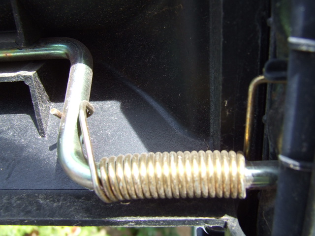

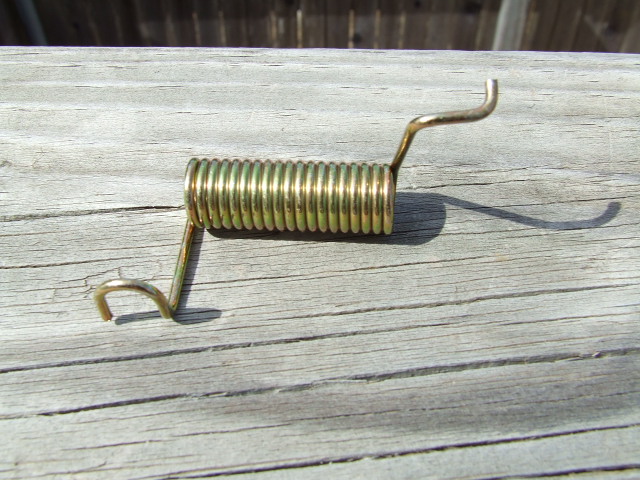

Spring in handle assembly
I also have the Toro 20018 Personal Pace. I don't have the serial number on me, but it's in the middle of the range. The handle end of the drive cable broke off. I replaced the cable as well as the plastic part of the handle that slides up and down. A couple of the plastic parts were broken off the handle, so I thought that I should replace it while I was working on it. I got it all back together, except that I cannot figure out where the spring that provides the tension to move the handle back to the "up" position anchors. One end clearly wraps around the steel rod that rests in the slot on the plastic handle. Where does the other end anchor. Based on the position it seems that it should rest in tension against the sliding part of the handle but that can't work because when the handle slides the end of the spring digs in and prevents the handle from moving properly. Not to mention that it leaves a scratch on the handle and would eventuallly wear out the spring, the handle, or both. If someone could post a description or, better yet, a photo or diagram of the proper position of the spring I would certainly appreciate it. Thanks, Tom.
I don't have a picture right now, but I can take one tomorrow for you. I bet your spring is actually broken, there is a "hook" on one side and it's pretty easy to figure out if the spring is complete. The first time I ran across a broken one, I spent quite awhile trying to figure out how it was supposed to go, once I discovered the spring was broken and got a new one, it was easy to figure out how it was suppose to go on.
The "u" shaped end goes around the rod that moves when you slide the handle. The "L" shaped end goes into the hole in the handle bar "steel". The spring can be wound up to increase the tension on the sliding handle. It should be pretty straight forward as the hole should line up with the parts in place. Good Luck.

Pictures
http://www.imower.com/images/spring_1.jpg
Here is a picture of it installed
http://www.imower.com/images/spring_2.jpg
Another angle of it installed
http://www.imower.com/images/spring_3.jpg
Hope this helps you some.

Handle spring is broken !
30yearTech, you nailed it! The spring is broken. The "L" is broken off. I have the hook on the other end and, as Camino Kid mentioned, that connection is pretty obvious. It was the other end that I could not figure out. Like you, I tried it every way that I could think of, but nothing worked.
I am betting that a new, complete spring will clear my problem right up.
Thanks to all for replys and, especially to 30yearTech for the photos. -Tom
