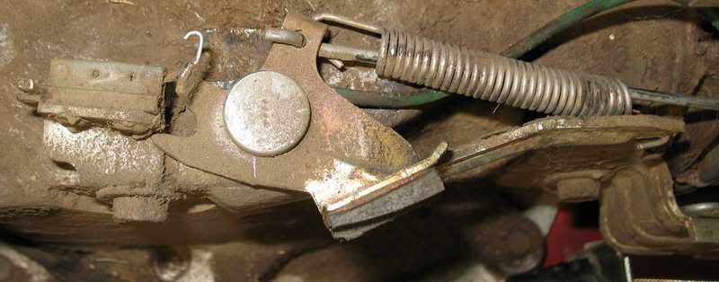

I got the flywheel off. I was unable to knock it off using the method describe by puey61, so I broke down and bought a puller from the local tecumseh shop. It worked great; I got the flywheel off with no trouble.
Once I got the flywheel off, I did not see the bent brake described by AMINO KID. As far as I could tell, everything looked fine. See what you think; I took a couple of pictures:
With the deadman bar release:
With the deadman bar engaged:
I put everything back together and the it started twice in a row with no problems, but I'm not going to get my hopes up. I'm going to run it tomorrow and I see how it goes.

It does look like everything is working like it should there.

I see by the pics that you have both fairly excessive wear and uneven wear with the brake pad. I'd recommend replacing the brake arm assembly. And you should consider replacing the brake control cable since it appears you may have trouble with this as well.

Thanks for the replies, I ran the mower for a couple of hours yesterday and it ran fine and started every time with no problems. Since that was hopefully the last cut of the season, I'm going to take it apart again and clean it and replace the brake arm assembly.
