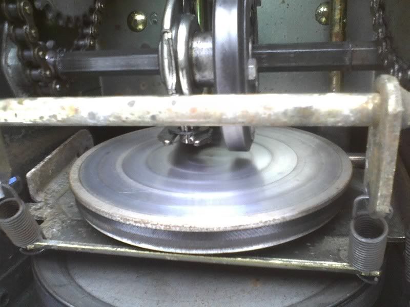

Getting there. The drive engagement is adjusted a bit differently than I am familiar with. There are actually two cables in series that actuate the drive by pulling the swinging plate aft towards the friction plate. Any excess play is taken up by removing the slack in these combined cables.
Between (and connecting) the cables is a small plate with multiple drill holes that can accept the bitter end of the cables. By repositioning the bitter end of one or both of the cables closer to each other on this plate, the belly is removed from the linkage.
A bit of WD-40 and some light grease on the yoke and shafts assemblies makes a huge difference in the ease of shifting. After lubricating the mechanism a few shots of degreaser on the friction plate and wheel faces helps maintain a good contact between them.
Speed change is effected by shifting the wheel across the face of the friction plate. The further from center the contact is made the faster the tires turn. Passing the wheel across the center axis changes direction.
Be aware that over tightening the cable will cause the entire drive train to run continously - I think.

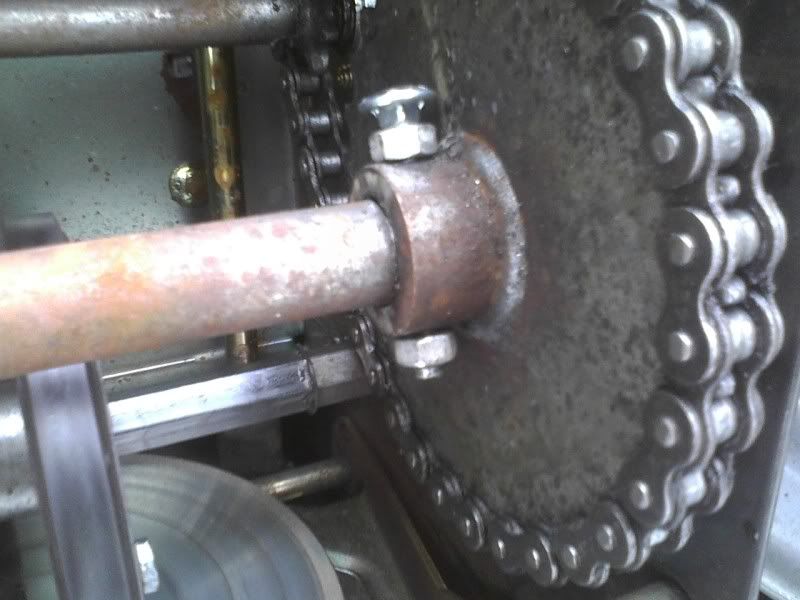

ok i know this is old thread but im reviving it
same problem here with my blower and while the info helped me focus more on finding out where the broken bolt came from instead of tearing it apart and changing the rubber friction wheel
so i thought i would take a few pics of mine and the repair there are a few things that could go wrong and of course the cables could break or need adjustment and that is easy self explanatory fix just follow the cables down from the handle
then could possibly be the friction wheel is wore out and needs replacement or adjustment and that looks like a pretty easy job as well.. here is pic of the friction wheel the big flat one moves back and forth and makes contact with the smaller rubber wheel when you squeeze the handle and it pulls the cable
in my case it was the bolt that goes through the axle on the right ( looking at from behind) inside wheel sprocket that the chain goes on
and this is the bolt/clip/pin whatever u have in yours that is on outside of left wheel to make it spin with the right wheel
and it is a craftsman blower 9hp dont rem the model and in my owners manual there is a section on how to adjust the little rubber wheel to make sure it is hitting the big flat disc in the right areas when it is in certain gears i will pust those number later

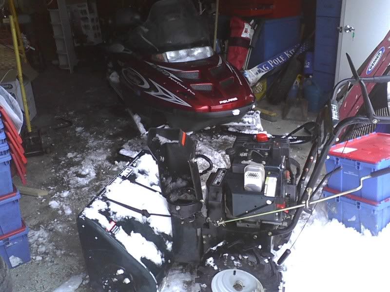

This may sound like a dumb question but how do you guys go about having easy access to the bottom of the snowblower without breaking your neck? I turned it on its side and oil and gas started leaking out.. Which also doesn't seem right ha. sorry i'm a tad ignorant when it comes to this stuff !!
Hah!....working on the exact same snow thrower pictured above.
Grab the handles and lift up so the machine rests on the front opening.
Might have to take some fuel out if your cap doesn't hold back the fuel.
