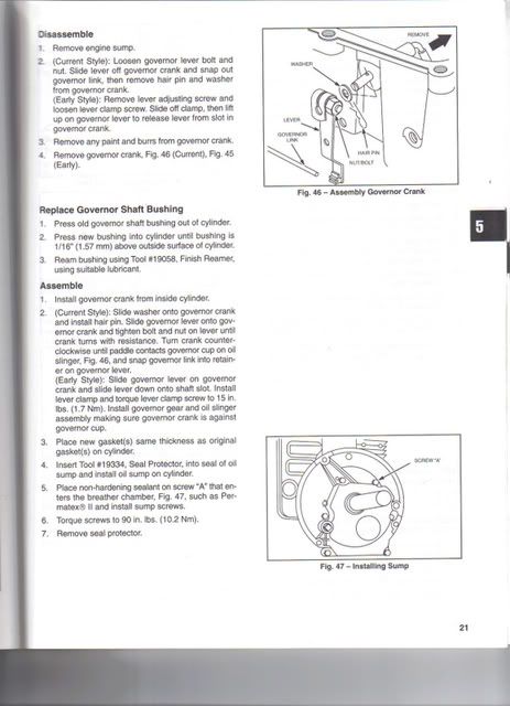

OK,
The above procedure is typed as in the Briggs service manual, Lets go over it in my words;
When you moved your throttle cable to full wide open/choke position the governor arm should have moved to the right rotating the governor shaft clockwise. When the governor arm screw was loosened the shaft should have been rotated clockwise and held with a light pressure while the cable is still at full/choke position then the screw tightened.
If you have up and down play in the governor shaft the shaft and or bushing is worn and in need of replacing, The bushing is a replaceable part but must be finished reamed after doing so;
Another thing to check is the locating hole in the governor, After so many hrs. the hole will get elongated and this will cause a non-functioning problem.

Oh, I know how this works, Below is what I am speaking of;
If the governor can be moved around on the camshaft it needs to be replaced.
The governor lever has two holes. One holds the throttle linkage(top).The other holds the Governor spring.

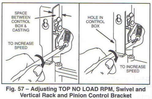

Originally Posted by 31YTech View Post
You could have the high speed adjustment tang bent too far, The tang the governor spring is hooked to on the throttle control box. You may try bending it to put less pull on the spring when the throttle is at wide open position and see if it lowers the rpm.
This is what I was speaking about above;
This is located behind the throttle control assembly that your cable hooks to.
