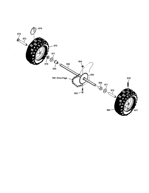

Hi, have a 3 year old Sears snowblower 11 horse power 30" mouth.
Was working fine till it would not go forward or backwards.
I pulled off the bottom plate and checked and all I could fine was the bolt or pin was broken off the drive shaft. I punched out the old one and tried a regular 1/4" bolt and nut. Worked for a few runs and bang, broke again. Tried a clevis pin and that broke off too? and again another bolt, same thing. Why is that happening? Sears coming in 2 weeks and I can't get car in the backyard as too much snow.
Help is appreciated, thanks

Is this the drive system you have ? Is reference # 653 the bolt that keeps breaking ?

Hi, judging from the pic, #655 looks more right...The pin, bolt or clevis pin or what name it has goes in the sprocket closer to the wall. Only one side has that support, the other wheel does not have that sprocket ...

#655 is the axle bushing, #653 is a 1/4" bolt that goes through the sprocket and axle shaft to keep the sprocket from free spinning on the shaft.

Does sprocket #652 Wobble on the shaft ? Thereby rubing against the pin or bolt,cutting it in two.Or does the axle wobble in bushing #655?

Answer still not solved but from the manuel pics, appears that a nut and bolt go through the drive sprocket and shaft.
Only one bolt supports the drive. What bugs me is that the bolts snap too easy. At least you think a regular bolt would last for one driveway clean up.
Is there a special bolt to use? or is something possible wrong as too much torque snapping the bolt off.
This bolt goes through the sprocket and shaft, thats it. Does not rub or even near any other parts.

This is why I asked if the wheels spin freely with no bolt/pin etc. in the sprocket/axle assembly, The only drag on the axle/wheels is the axle bushings. I see no way for this axle to be pinned/dragging in these bushings tight enough to sheer a bolt.
Try a Grade 8 bolt with the six marks on the head as above and see if that solves the problem.

The correct bolt is a grade 8 bolt however there should be no threads in the gear. It needs to be too long so that when you tighten the nut the bolt will still turn & there is no threads in the gear. If the nut is tightened so that the bolt won't turn or there are still threads in the gear it will break. The vibration will cause the nut to continue to tighten until it breaks the bolt. An impact with a solid object will break it also.
