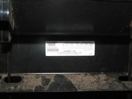

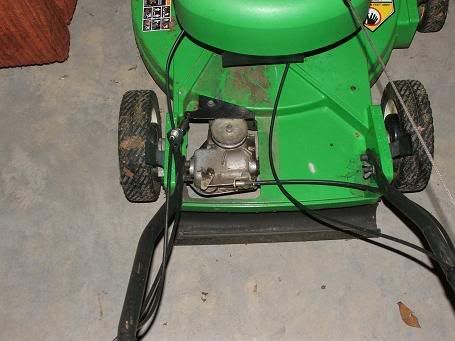

I am looking for the transmission for this Lawnboy mower. Anyone any idea where I can find a used or rebuilt one? If not, how about a new one?

Wow, no kidding. Ill definitely attempt that. Is the problem typically easy to diagnose once it is opened up? I was given this mower and just told that the transmission needed replaced. ..that was it.

I hand turned the pulley on the transmission and it seemed like it wanted to turn the axles but then slipped. You could feel the gears grind a bit. Im thinking maybe something is stripped inside??

Here's a breakdown on your model transmission:
https://lookup3.toro.com/partdex/sit...m?xcaller=Toro
Looks like a 1998 model mower and transmission looks like a mini version of a rider transaxle, i.e., with shift keys, 3 speed??
Might be the input shaft pinion gear or the bevel gear it drives could be a problem. (ref 23 and 7)

I just pulled the transmission out and opened it up. Everything appeared to be in good working order. No stripped gears or anything of the sort. My thought is maybe the shift keys. The key looks to be slightly worn.
When I put it back together and hand turned the pulley, the axles turned well. However, when I applied a good amount of pressure to the axle, it eventually gave and it seemed to be slipping.

A couple of questions. I removed the transmission, replaced the keys and reassembled the mower. When I started it up, I get a fast clicking noise when I engage the self propulsion. I did not see any damage to the gears and everything seems in tact. The roll pin appeared ok, but I was not able to replace it because I couldnt get it out. Anyone have any suggestions on how to remove it? Also, if it were sheared, would there be any visual evidence? I am able to hand crank everything and that works well. It just seems that when the torque is a applied, thats when there is a problem.
