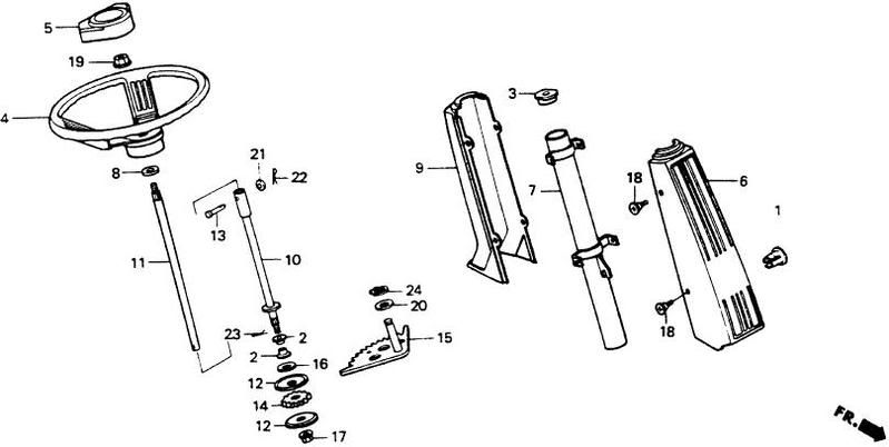

For the life of me I can't figure out how to fix a part. Under my mower is where the steering column attaches to a gear. This gear interacts with a big gear that has a rod that attaches to the wheels. This gear is my problem. It is almost frozen. On the upper side of the deck is a compression ring and washer ontop of the rod that goes to this funny gear. After I took them off this piece doesn't budge. Please help me get this off. I have a pic. I can email. Thank You, sorry I don't know the correct terms.

If you haven't already, Get a can of quality penetrating oil and spray the mess out of the sector gear bushing and let it sit over night. Remove the drag link joint #23 from the sector gear #4.
Spray more penetrating oil and tap the bottom of the sector gear with a hammer while holding a little pressure turning the steering wheel. Keep spraying and working the steering wheel back and forth and see if it will loosen up.
Be careful, You don't want to turn the steering wheel too hard and strip the gears.
Good Luck

Thank you for responding. I tried all you suggested with no success. I think I need to take this sector gear off. It does not come off though. My mower is different then the one you have pictured. It uses one compression ring instead of cotter pin. When I remove the ring and coresponding washer, nothing budges.

OK, That other pic came out of a generic service manual, Here is the set-up you have;
Has this mower been sitting out in the weather for a while or went through a flood ?
You may have to strip all you can out of the way and apply heat to that frame section to get it loosened up, As you can see it is a removable/replaceable part so ya gotta do what ever it takes to get it loose.
