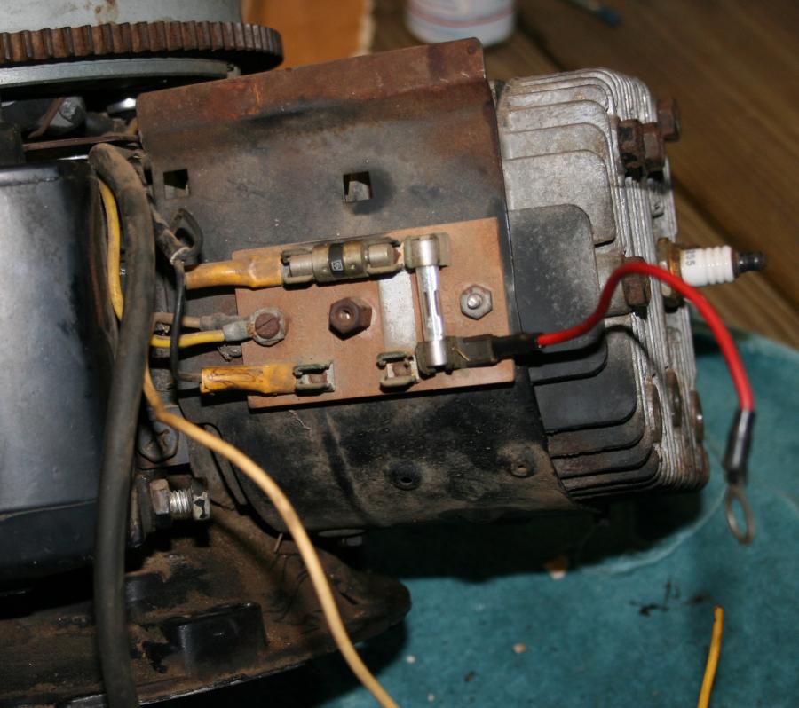

Hi All,
My father gave me a "it used to work" 5HP engine to see if I could get it working in spare garage time for fun.
First, I've determined that I have a Tecumseh V50-602144 with serial number 2340D. Old school.
I cleaned out the carb, bought a new spark plug, and bought a new air filter for it. Now I'm stuck on the wiring -- basically everything was just clipped off when it was removed from whatever mower it was attached to.
I'm just trying to get the piece to make even the slightest noise or movement at this point, which will motivate me to continue further!
I'd be grateful for any assistance. Here's an actual photo of what I am dealing with and also a diagram from the Tecumseh Technician's Manual (which I have).
I have no idea what goes to what! The fuse looks fine and the diode checks out as well.

Apparently this engine has a charging circuit to maintain a battery or operate some other accessory such as a light.
These wires do not need to be attached to anything in order for the engine to run, however I would suggest not letting the red wire touch the engine block or any metal surface the engine is mounted to when the engine is running.
Have you check the spark plug lead wire to see if you have ignition spark? This engine is old enough to have points and condenser setup underneath the flywheel.

Yes, you will get spark without a battery. The ignition system on this engine does not have a battery excited coil. You should be able to spin it fast enough by hand to get a spark if it is a point type setup.

I actually got it to idle tonight (without using my tongue) ... once I realized the choke plate was wide open and closed it. Seems to idle well.
