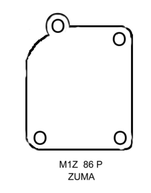

Well, I'm not having any luck in my part of the world in finding a diaphram & gasket.
The carb is a Zuma and on the diaphram cover it shows
M1Z 86P. If there are other numbers on the carb I don't know where they are. Any suggestions of where to look ?
I've checked out the carb for blockage and crud in it and it's clean such that solvents travel thru each orifice.
Since I last posted a guy gave me some material to make a diaphram with. I think it's a bit thicker than the original.
If it starts it will run at low speed or if accelerated it will run and die within a few seconds. This material was used in air brakes and made of neopreme.
Here's what the diaphram looks like:
Are there any good online sources to find parts for this ol' Mac ?
Old 09-11-08, 12:30 AM
cheese's Avatar
Join Date: Jul 2001
Posts: 17,253
Received 22 Votes on 19 Posts
I don't have any online reccomendations, but I don't think you'll have any luck with the diaphragm material. There should be a metal disk that is an integral part of the diaphragm that would be very difficult to duplicate with any precision.
