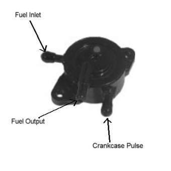

thanks. that is a good idea to ddrill the hole in the valve cover. Do you have any idea which of the three fittings on the B&S fuel pump are vacuum, in and out? I thought about going to sears to see if i could see how one was hooked up. It has the one fitting on front and two on side

If it's like the one on this Briggs engine
The one on the right ( normally bottom) goes to the tank, the left side goes to the carburetor, and the far side goes to the crankcase.

Take a look at this and see if it helps any.

Thanks 30yrtech
That's it! You think I could simply put a T connector off of the rubber hose that goes from the current valve cover to the carb manifold instead of drilling into the valve cover? Or what about drilling and putting a fitting on the oil fill tube like the briggs had? Thanks alot for the picture! I had the all wrong!
Old 09-03-08, 03:08 PM
30yearTech's Avatar
Join Date: Oct 2006
Location: Central Texas
Posts: 1,176
You can attach a line just about anywhere you can get crankcase pulse. The breather tube however is too thin and soft, it will expand and contract rather then pass the pulses to the fuel pump, or at least I think it will.
