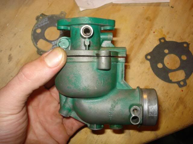

Thanks for the help so far folks. I had a little time to tear this carb off again and break it down.
Cheese....after it sat out in the garage a few days, it did appear to have a very small leak. I found more gas on the lower part of the carb before I took it off tonight.
Here's a few pictures...
You can clearly see the gap here (held upside down):
You can see the gap is more pronounced on the right side of the carb here. (This is where the leak is occurring)
You can see how the flanges where the through-holes are for the assembly bolts seem bent upward (downward when assembled)
Any ideas how this could happen? Did I do something wrong during assembly? Can the flanges be bent, or should I just start filing away?

ouch...that doesn't look right at all. I'd guess that something is bottoming out that shouldn't be. I don't know if I have one of those carbs to look at in the shop or not. Take a close look at the 2 parts and see if you can see what is hitting and keeping the two halves from going together. If there was just a little gas wetness on the bottom part of the carb, I don't think I'd worry much about the needle seating. With a gap like that, I would expect some fuel seepage over the edge. Now if it's dripping, that's another story. Still, you need to fix the gap. Something is more than just "warped" here. Something is interfering with assembly.

Something is more than just "warped" here. Something is interfering with assembly.That's exactly what I thought too, but there's nothing in the way...I've checked repededly. Here's a little history on the generator: I got it from my next door neighbor who decided to go to his country home that had power when the power went out here during hurricane Ike. When he got back, he had a new generator with him that was powerful enough to run his pool pump and a few other things...must be nice.
He said that he had the generator "serviced" last year to the tune of about $150 and that "he didn't want it back in his garage". I don't know what was done, but the carb could have been rebuilt during that time...it could have happened then. The whole time I used the thing...it leaked a little gas. I didn't notice it until the 2nd or 3rd day, so it was like this before I cracked into it. It was not as extreme as it was after I did my rebuild, but I'm guessing that's because of the new gasket.
Upper carb body part #399443: $47.75...ouch (this is why I'm asking about how to repair).
Assuming nothing is in the way of assembly (nothing is), how would you approach correcting the bends?

I packed up the disassembled carb and took it to a small engine repair place to get some more ideas and the owner took one look at it and asked if it was leaking. He said that he's seen tons of these carb and that they all have leaks after a rebuild. The flanges with the holes for the assembly bolts are always the culprit. He said they've tried double stacking gaskets, #2 Loctite, and filing the surfaces...nothing works. He said filing the surfaces made it worse. I looked at it pretty good with the idea of filing it down, but decided that the best way is to file the lower assembly to accommodate the bends in the flanges. If it doesn't work...I've ruined a lower assembly.
I will bite the bullet and buy an upper assembly from Briggs and go from there...exactly what I was trying to avoid.

If you're set to buy a new top part anyway, go ahead and see if you can bend the flange straight again... if it breaks, you were gonna buy a new one anyway. I've worked on a lot of these and don't ever recall seeing one bent like that.
Thinking about it... how can simply rebuilding the carb cause the flange to bend? (unless they have a gorilla rebuilding carbs for them). I don't buy what the guy told you because I've worked on many of that style carb without problems like that. I don't think filing is the answer for yours either. Your flanges are too bent for that. I'd try to straighten it or replace.
