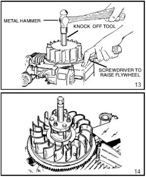

You would need a battery that is capable of delivering at least 9 - 12 cranking amps. You would need to know the CA rating of the battery you want to use. If your engine is equipped with an alternator, there should be wires coming out from under the flywheel to supply the AC power to a rectifier/regulator assembly. On Tecumseh engines there are generally three small holes near the center for a flywheel puller to be bolted on to remove the flywheel. I gear type puller can damage the flywheel.

According to the parts lookup I have there isn't an alternator on your engine. if you do pull the flywheel don't loosen the stator plate as this will change the timing. If you need to replace the points & condenser you will need to re time the ignition. Here is a picture of the pullers that Tecumseh recommends:

Alright, so I went and looked at the IPL for this engine as well and I don't see an alternator for this spec number either. If this is the case, you will need a new flywheel in addition to the alternator in order to charge a battery. This will be quite expensive. I would recommend just periodically charging the battery used for starting with an external charger.
Has your engine ever had an electric starter on it? If not, then your flywheel likely does not have the ring gear on it.
