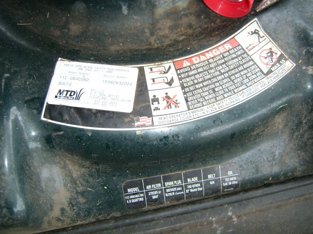

Well I tore the mower apart again since my last post. I'm starting to think it could be the gasket between the gas tank and the carb. Or it could also be a little O ring inside the intake.
Here are some pic's of it:
Pic of model & serial #:

Now, it looks as though you have a spring that doesn't belong and one missing(check the photo below), the model number posted is for the mower, not the engine. The engine model, type and code which you will need to get the proper springs is on the metal flywheel shroud just above the spark plug, you will need to tilt the mower or remove the plastic cover to see them, the diaphram kit you need is 795083 or old 495770 I will cover it's installation below the picture. Have a good one. Geo

MTD is misleading because they put the model number of the mower right about the 4.0 quattro (engine) name). Engine model is the 10h902. You can download ipl at briggsandsratton.com
