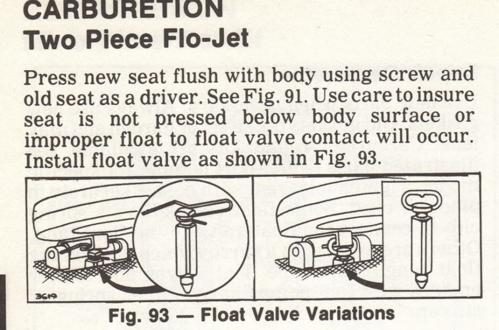

Hi,
Briggs Stratton model 190402 type 1809 01 and code is79020812. It is an 8hp engine for a chipper. I am looking for what I believe is the float seat. It is a brass bushing type not a screw in type like those made later. I have looked thru the online parts diagrams but I don't see where I can get just the brass bushing seat itself. I have been told however that it is possible to get them.
Anybody familiar with this carburator and know where I can get the bushing? Briggs and Stratton pointed me to the 394681 Needle/Seat Kit but I don't think that has the bushing type seat.
Thanks for any insight
JL

I don't know who you spoke with but if it was indeed the Briggs factory and they could not offer you more then shame on them. The Briggs part number you need is 364682 for gravity feed systems or 394683 for pump fed systems. Each includes the inlet needle, the clip for the needle and the press-in brass seat. I've looked online for a downloadable Briggs 270962, service manual for instructions on replacing the seat but I came up empty. Perhaps someone else here can find one. Or, you may want to pick one up at your local Briggs service shop.

Here is the info from the manual. Have a good one. Geo

Wow .. thanks guys for the help! Puey61, that does look like the right seat. I am going to order one up and see. And thanks Geogrubb for sharing the info from your manual. I really appreciate it!
Thanks again!
