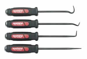

primer bulb removal tool
Is it recommended to use a primer bulb removal tool to snap out the locking ring and then the bulb comes out.
I have a Tecumseh engine on the lawnmower and I am not sure if I can remove the bulb w/o using a special tool.
there is not much room to work with, I would be concerned about damaging the existing bulb as I am transferring it over

Jack,
I bought a set of picks off Snap-on many years ago, I use the second one down and go behind each of the little ears on the retainer clip while lightly pulling out on the bulb.
Of course I don't remove them for re-use but if they HAD to be they could, A new bulb and clip is only 5-6 bux.....

picks worked on removing primer bulb
Thanks 31Ytech, I bought a cheap set of picks
at the hardware store and it made it easy to remove
the primer bulb rather than spending 20 to 30$ for a special removal tube.
