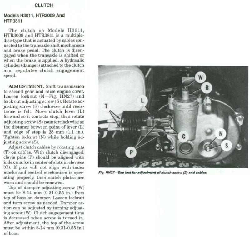

I would like to adjust the clutch on my Honda 3009 lawnmower. It just feels a little grabby. If anyone has a service manual for one of these please scan the page that pertains to this. Thanks.

Here Go......
Good Luck
