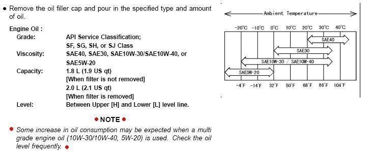

For the reason noted below your engine may like straight 30 or 40w instead of multiweight.

I use SAE 30 in all summer use engines and 5W30 or 10W30 in snowblowers and winter use engines.
