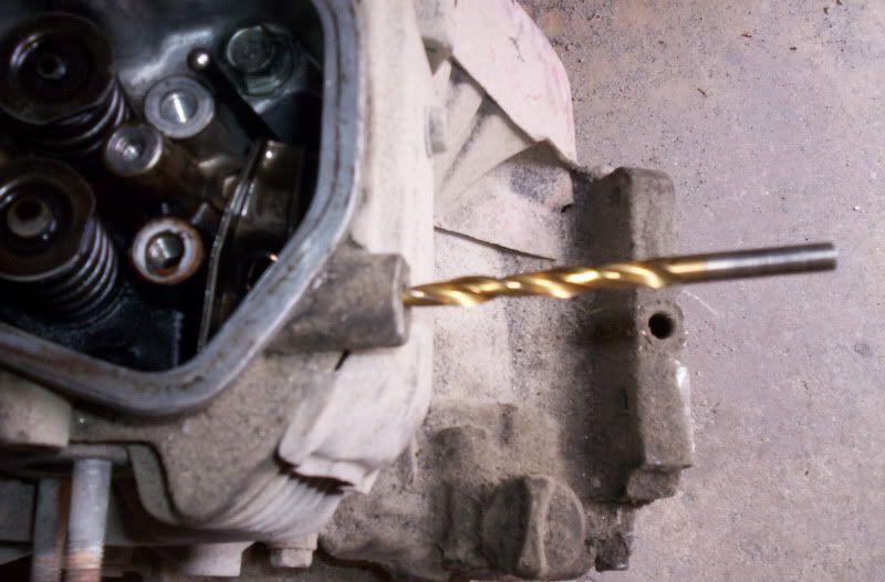

OK,
Here's what I Have......
There is a blind threaded boss on the bottom of the head, You can remove the valve cover and place a rag in the bottom of the head to plug the oil return ports so shavings don't enter the crankcase.
Use a 1/4" drill bit and drill the boss the rest of the way through the head.
Now, With Briggs part # 691609 or Kohler # 25 155 02 elbow fitting measure the thread length. Drill the boss the same distance as the threads only then use a 1/8" national pipe thread tap and tap the boss, Screw the elbow into the boss and you now have a impulse port;
You can now install a impulse style fuel pump like Briggs part# 808656 or Kohler #24 393 16-S;
Mount the pump higher than the elbow fitting someplace on the generator frame (example);
Now you can add any tank you want and even go back to the original gravity feed tank by simply hooking it up to the fuel pump.
Fuel pump, Around $35 USD
Elbow fitting, Around $3.00 USD
Good Luck

That's the way to go. Nice pics and description 31YTech!

31YTech, wow, thank you so much! Nice pics and step by step including part numbers...looks like I have a nice little project to do one of these weekends.
One quick question, what is the typical size for the gas line tubing using the elbow and pump you have listed?

Also, with the elbow and threads, should you put some sort or tape or putty on the threads prior to threading it into the boss?
#26
The size fuel hose needed is 1/4" and yes put tape or some type sealer on the elbow threads.
Here is the fuel line hook-up.....
The idea behind the fuel pump install is to do away with 18 gallons of gas being gravity fed, As Airman posted that much weight might pop the float valve off the seat and flood all over.
With the top of the 18 gal. tank mounted level with or lower than the fuel pump there is NO chance of flooding, The fuel pump will only operate when the generator is running. A in-line cut-off valve between the tank and fuel pump is not a bad idea if you "T" into the fuel input line with the original tank as a back-up.
Have Fun !

I have a question with regards to the boss below:
The boss is located below the valve cover and therefore, should I worry about oil getting into the line?
#37
No,
The return holes in the bottom of the head are large enough oil will not puddle into the hole. Now, A little oil splash may enter the hole. For this reason is why I said "Mount the pump higher than the elbow fitting", You don't want a downward sag in the hose going up to the pump either go straight out of the elbow up to the pump. This will eliminate the hose/pump from filling with any splashed oil.
