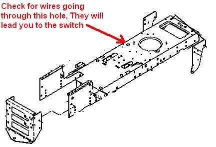

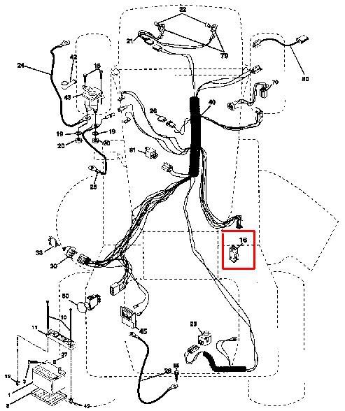

Here is your unit, The switch in question is in red;
Even though it's shown above on the right hand side look below;
The button on the seat switch plug is a second switch, This seat switch plug connector must be pushed on the switch tightly for the second switch to function properly.
I keep going for the clutch switch because it's a two way switch, When the clutch is pushed it opens the safety system contact and closes the start system contacts so the engine will crank. You don't have to be in the seat to crank the engine as long as you keep the clutch pedal pushed.
Once the engine cranks and you let the clutch out while in the seat the start system contacts open and the safety system contacts close and activate, Now if you leave the seat the safety system will open and shut the engine off.

OK The switch I checked was closer to the left front wheel, it seems to go in to something in front of 1 of the puly's, I will put this baby in the air on jack stands & get to work this is realy bugging me, I can work on my 318 with ease, This thing is driving me Nuts LOl Thanx gentelmen we will keep pushing forward. Thanx again kevin, I will report back
