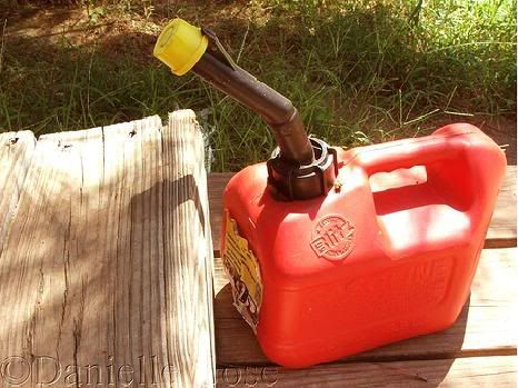

I use a one gallon can such as this for filling smaller engines, The spout is smaller than the tank filler hole which allows air to vent while filling. Use of a funnel will seal around the filler hole thus reducing venting and cause spillage while filling.

Thanks 31Y, a gallon can makes sense. Now. about filling a one-gallon can at today's filling stations!
