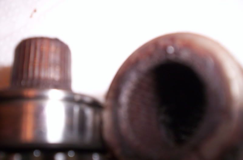

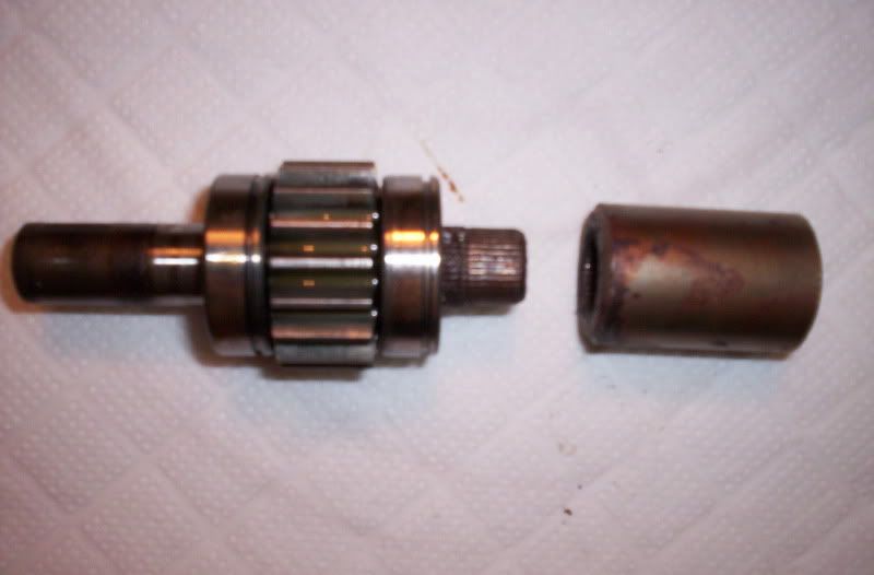

Ok I got it out and on the table and the pump pulled. The brake shaft collar came out still on the pump. I stuck it back in the unit on the brake shaft and no need for needle nose or brisk spinning...the thing is sloppier than a 3 dollar date...and I can spin it freely by hand. Can put a bit of a bind on it and get the axles to spin...
Didn't look too clean or spiffy inside. Rust colored puddy...not sure if assy grease got hot or water in system or both or....
Hope to get it split this week...depends on how the haying goes.

Looks like just the brake shaft and one bad bearing for the jack shaft on the reduction gear is all it needs, seal and O-ring and filter too.
Got the case empty and wiped down, not near enough debris to make up for the lost bearing pieces...prolly shoulda checked the oil eh?
Maybe I can check the filter to see if I can pick it up with a magnet

I did this job for a friend here at home to save him shop labor, I didn't have room in my home shop to work inside due to my old pickup getting a frame off restoration. So, This job was done under my canopy.
I took the pics because I knew it would be at- least a month before my friend had the money for parts (ended up being close to two). I just didn't want to rely on my memory with so much having to come apart for this type job.
Here's the pics I took showing linkage/brackets and hoses that had to be taken loose.
It's been plenty long enough, Post back in here you pulled two stumps at once !!! Beer 4U2
