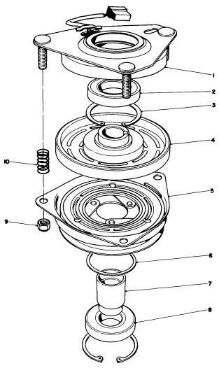

I have a craftsman 917.252714 rider with a kohler magnum 18hp twin engine. The pto clutch is making a lot of noise and I wondered if it could be rebuilt? Thanks for your help

Some of the older style clutches do have replaceable bearings while newer ones don't, You would need to take your clutch apart and see if it has retaining rings (snap rings) holding the bearings in place;

thanks for infor and diagram. I hope it can be rebuilt cause it is very costly to replace.
