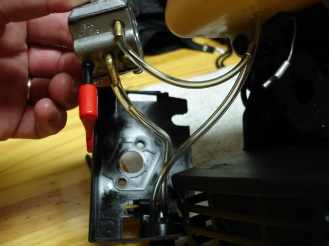

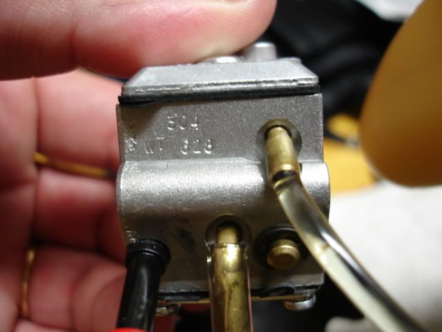

I have a 6 year old Craftsman Gas Line Trimmer, 32cc weedwacker, with a Welbro carburetor (WT-628).
Recently, it would not stay started and kept dying. I figured it needed the carburetor cleaned (possibly rebuilt) and the fuel lines replaced.
I went ahead and replaced the fuel lines (including fuel filter).
It still would not stay running other than in a mostly closed choke position.
I then took apart the carburetor and cleaned/soaked most of it in carburetor cleaner for an hour. I was going to reuse everything but because I had also soaked the needle - the carb cleaner ate through the rubber tip on the needle and it broke off - so I went and bought a rebuild kit (K20-WAT) from the local small engine repair shop.
I then replaced the needle, the needle assemble (but not the spring - the kit did not come with one), the screen, the pump diaphragm and gasket, and the metering diaphragm and gasket.
When I go to start it, I can prime the bulb a few times, open the choke slightly, and start it. If I open up the choke fully, it will die.
If I start it, again with only partial opening the choke and holding it at Wide Open Throttle (WOT), it will run for about 5 seconds and then die.
I had someone press the primer bulb every two-three seconds and it would stay running but only if they were priming the bulb every few seconds. If I opened the choke up fully and had them prime the bulb every few seconds, it would die upon opening the choke fully.
BTW, I have never adjusted any of the screws...
Oh, one other thing...because I read up here about the spark arrestor being a possible problem, I went ahead and took that apart (Wow, that spring is one tough mother!
) but that looked clean - I sprayed it with carb cleaner anyway and got it back together (Hey, I also got to see inside my engine (Piston, flywheel, etc... - never saw that before!
Can anyone assist? Here's some more pics.

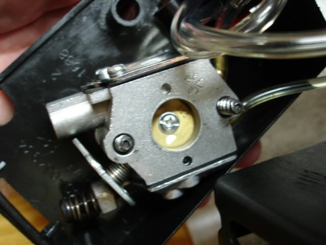

Here's some more pics I have (I guess I'm limited to 10 per post).
Oh, if anyone tells me to adjust that H or L screw(s) - how do you do it? I don't have that type of socket or fitting??? What is that?

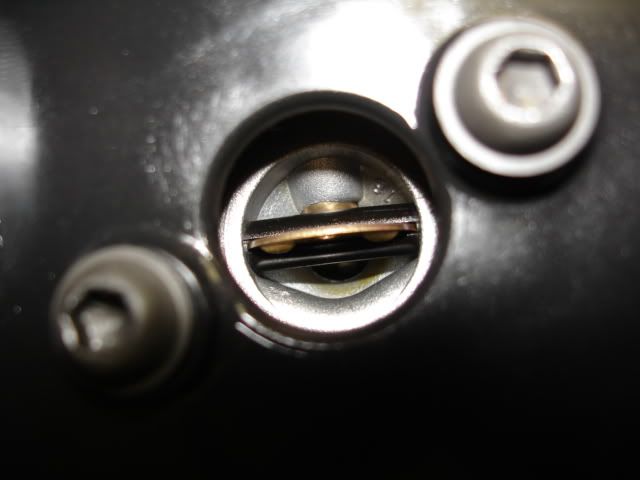

Before adjusting anything, I took apart the Welbro Carburetor again and made an adjustment to the needle (based upon a video I saw on YouTube about rebuilding a Welbro carburetor.
I was playing with a lot of adjustment to get it started - finally I got it started and running...but I still need to make final adjustments on this Walbro carburetor to get it running in optimum condition.

Some pics of the Walbro Carb needle adjustment
Here's some pics from taking the Walbro Carb apart one last time to double-check everything and to adjust the height of the spring for the needle. I adjusted the height of the spring needle based upon this 3-part video series on YouTube that I found about rebuilding carbs.
If you want carb info for walbro carbs go to Welcome to walbro.com and select the Service/Aftermarket tab, you will find lots of info. I always suggest using the old metering arm unless it is very worn as the old one has the proper height setting. Have a good one. Geo
