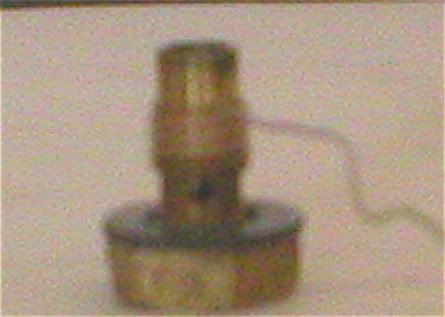

the bogging/hard starting of the engine is most likely a varnished up carb. The main jet (the bolt on the bottom of the bowl) is the most likely culprit. Drain all the gas from the tank (or shut off the gas if you have a gas shut off). Then remove the main jet and clean the holes. There is a tiny hole that everyone misses. That hole is 0.0155in (smaller than a paper clip).
If yours is adjustable,the screw setting is 1-1/2 turns out from lightly seated. The idle screw on the side of the carb setting is the same.

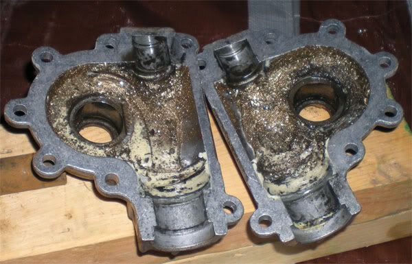

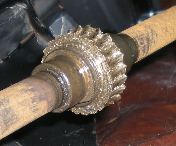

The prior owner was lazy, and only used bolts, instead of shear pins on the auger. The bolts were mangled so bad I had to pound on them to straighten them enough to get them off. I know Craftsman used bolts on some of their snowblowers by default, according to the manual, so I would check to make sure. If you have bolts, switch to shear pins ASAP.
I tore apart the auger and opened up the gear case, and this is what I opened it up to:
Don't let this happen to you
One problem solved, now to get the worm gear, put it back together, and start on the engine!

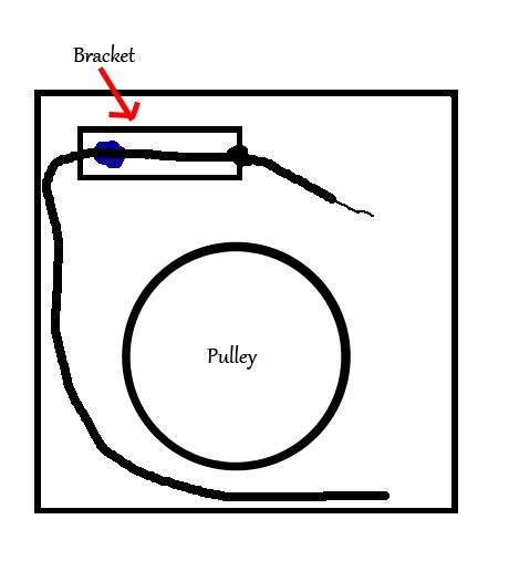

Hello, I have been having trouble with my snowblower as well. Last year I was cleaning a neighbors driveway and something got stuck in it and I smelled something burning. I shut it down and tried to use if a few weeks later. The impeller spins and the auger moves, but once it hits snow, they stop. The shear pins didn't break and I have disassembled it and checked everything. I am trying to reassemble it and am stuck at re-installing the auger cable. It has a little S-shaped piece of metal that goes in a hole behind one of the pulleys, but I don't know where to mount the piece of metal that is attached to the cable. There is a hole in the metal and a metal rod that the hole fits into, but if I mount it there, it gets in the way. Does anyone have a pic of this assembly so I can see where to mount it. It is a craftsman snowblower. I called sears and the guy couldn't help me, but he said that most models have the same setup as far as where the cable is attached. Also, if anyone knows why the auger and impeller stop moving, that would be great. I opened the gear box and it was in good shape, not like the one in the picture above. I also replaced the belt. Thanks a lot

The bracket mounts directly to the auger housing, above the auger pulley. There should have been a bolt to attach it to the housing.
Too dang cold to be bothered to go out and take a picture, so I drew up a quick, basic setup for the bracket.
If you look, you should easily find the hole where the bolt holds it in place.
Forgot to mark it in the drawing, but the cord should be obvious, and the blue mark on the bracket is the hole for the bolt.

SyrSky - great info. I fear I have the same with the worm gear. What is the best way to get the auger blades off? Disassemble the housing or try to pull the impeller and all out through the front?
Great pictures by the way - hope I don't find the same when I open the gear box.
