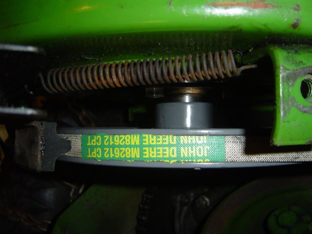

I
Join Date: Jul 2011
Posts: 5
Received 0 Upvotes on 0 Posts
Wow, someone else in the same situation I was in! Unfortunately, I had the sheave, I just wrecked it trying to get it off the shaft (with a puller) so that I could straighten out the impeller blades. For the John Deere purists, good luck finding the am105653 sheave. Otherwise, look for TB Woods part # AK841. I just put it on and it seems to be a direct replacement. It is a heavy (4.2 lbs) cast iron sheave with a gray primer finish. I ordered a replacement belt from john deere and it fits this sheave perfectly. The cheapest place I found the sheave was zorotools.com (ya, I had never heard of it). Sheave came quickly and was a genuine TB Woods sheave. $22 wasn't too bad either. Key slot is identical. I had to lightly file the slot because the new john deere key (go to the hardware store, it's cheaper) was fitting so darn tight I would have had to beat the sheave on. It comes with a allen set screw rather than the square head bolt with the jam nut. Use some blue thread lock for the allen set screw to keep it in there.
Hope this helps you all and others randomly searching for am105653!

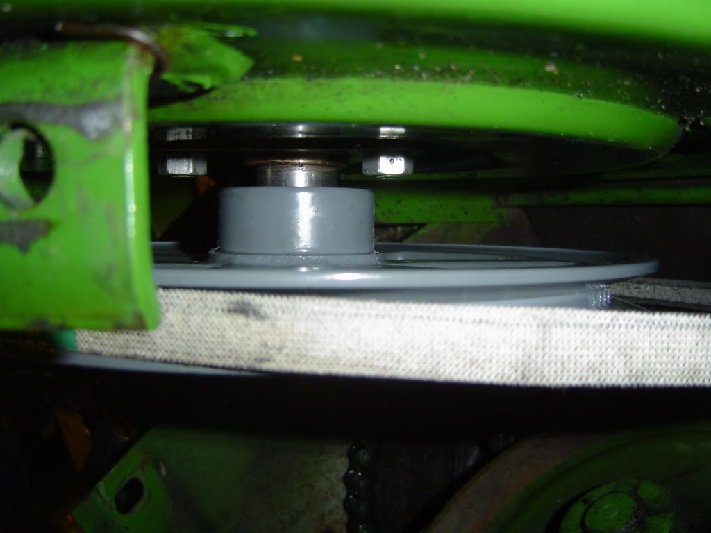

Old 07-24-11, 05:37 PM
I
Join Date: Jul 2011
Posts: 5
Here it is installed. Just finished bolting everything back up yesterday. Fired it up today... the 826 is ready for some snow!
  #21
Old 07-25-11, 07:36 PM
bontai Joe's Avatar
Join Date: Apr 2004
Location: Pennsylvania
Posts: 538
Iowa wrench, THANK YOU for finding a decently priced replacement part. And it is a significant upgrade in quality vs. the sheet steel original.
