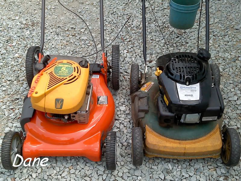

Can you spot what's wrong in this picture?
Yes, I have thrown in the towel. I broke down and bought a new Husqvarna since I could not find the problem with my old engine. I was so impressed with the quality of the new Husqvarna mower that I pulled the motor off and put it on my old Yard Man chassis. The old engine is now on the bench. I'm dying to find the cause of the problem. Now that I have a running mower again I have the time to take the old engine down looking for a cause.
PS: No, I did not bother mounting my old motor on the Husqvarna chassis. It's just sitting there for the photo.

Ummm..PD...I have to ask....why the heck would you pull a motor off a brand new mower and put it on an old chassis?
If you were going to do that...why not just buy a bare engine?
Seems like buying a new Corvette to take the engine out and put it in a '67 Stingray....lol. At least to me.

Maybe it's the heat, economy, stars, planet alignment or whatever but I don't understand destroying a new mower to fix and old mower. Have a good one. Geo

Oh, believe me. The humor, or lack of intelligence is not lost on me. I am glad there was nobody around because I was cursing like a sailor as I swapped engines wondering what just a motor would have cost.
I post enough on here I might as well show the not so proud moments.
I will feel even more stupid if I end up finding a simple little problem in the old engine that I overlooked.
