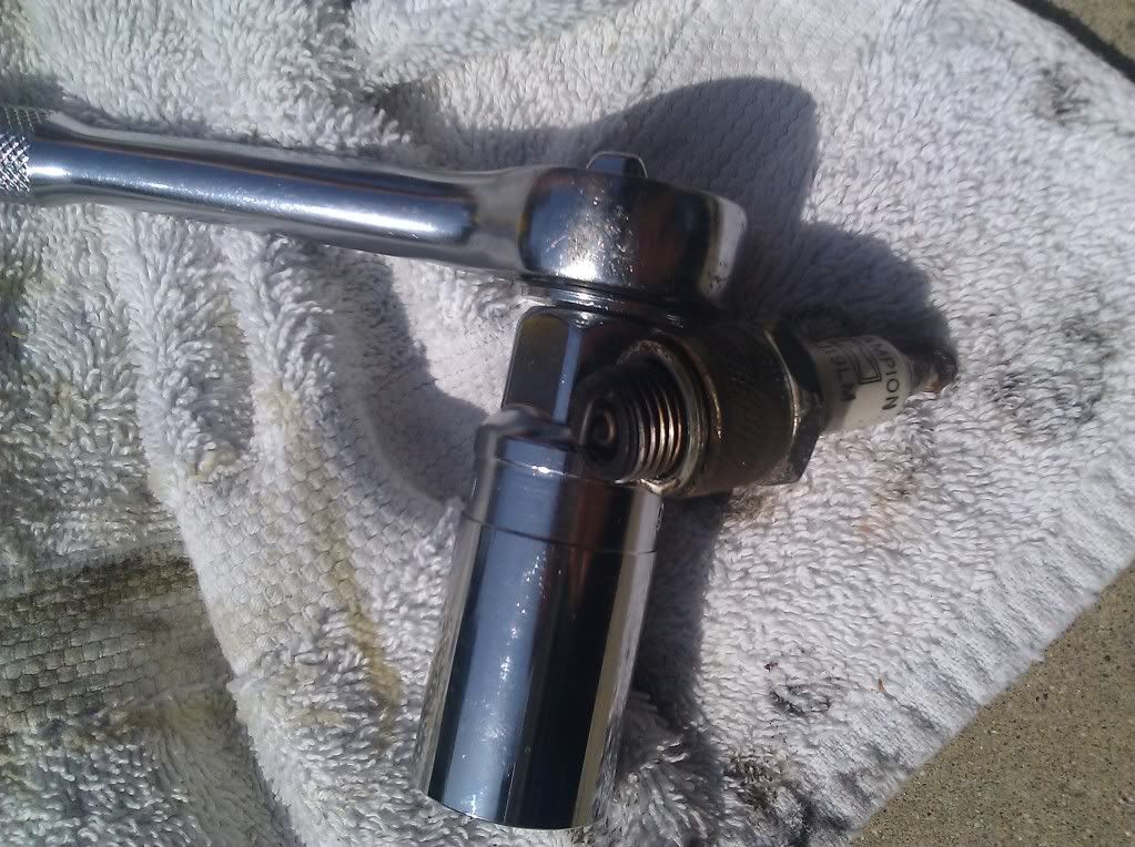

I checked the spark plug and it looks pretty bad and it's only been run about 30 mins since I changed it. So I tried installing the old one and the engine didn't surge until after about 10-15 seconds. I then took out the spark plug and it was more dirty than when I put it in. Here's a pic:
I tried the sea foam after the spark plug, added about 2 oz to the fuel tank and ran it for about 5 mins. It's still surging. I'm at a loss...
