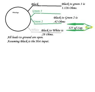

Thanks for the EX. It does seem like a lot of tedium.
I guess I'm back to locating the company in China that can help me wire the original Electric motor up.
http://i55.photobucket.com/albums/g1...ngOHMsjpeg.png
Maybe sombody can tell me from my "Ohm" readings?

I'll see if I can make that photo better. When I created that Drawing I'm sure it was a 640/480 for std Internet moving. I'll squirm harder....
I'm having a real bad day with stuff that should fix easy, but without an Air Compressor a lot of chores become labor intensive struggles.
Here's what I think. I'm kinda skeert of trying it though.
I think the black is the Switched/fused Hot.
I think the White and Green 1 get tied as the Neutral.
That should get the Start windings going though the Cap. Then when the Cap is charged, the Nuetral is the return from the Run windings.
