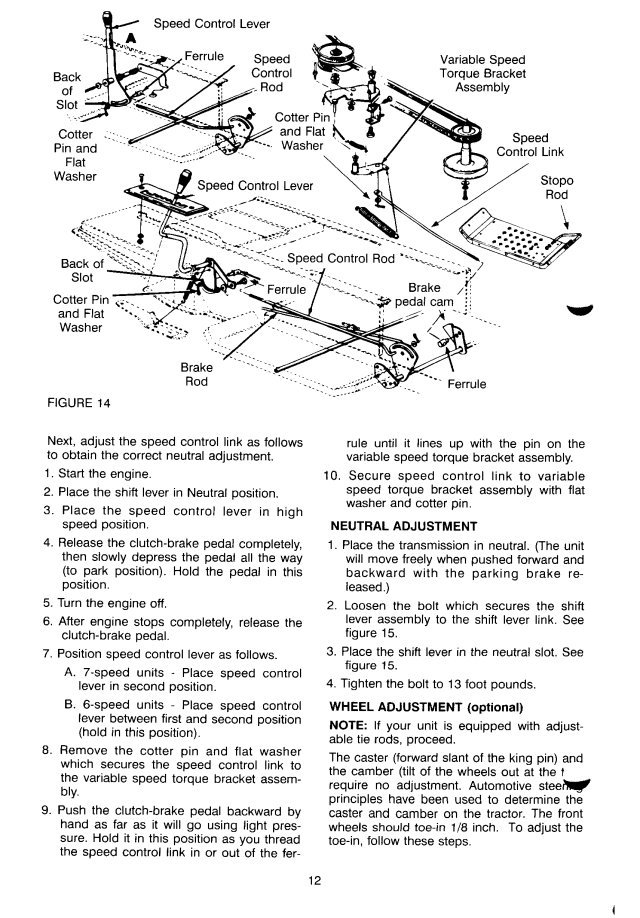

and there is a setup procedure to follow after changing the belts.
read these
http://web.ncf.ca/da229/pics/mtd-adjust1.jpg
http://web.ncf.ca/da229/pics/mtd-adjust2.jpg

Thanks ve, very much. Very helpful. I will try suggestons,
