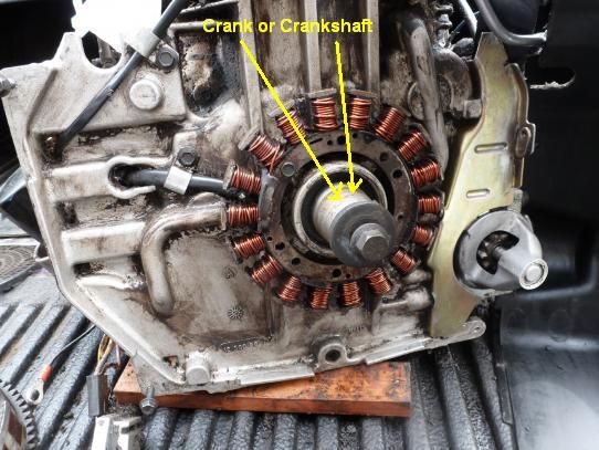

Hello spirittoo,
I'll try to answer in order and hopefully not skip anything.....
The coil mount screws torque to 35 in. lb., Flywheel bolt is 49 ft. lb.
Yes..... This is where you want to do this;
This is the crank or crankshaft I'm speaking of;
The plastic screen in the pic next to the flywheel just pops over the pins/nubs sticking up on the flywheel fins, Align the slots with the pins/nubs and snap it on.
The last pic looks like the parking brake safety switch, It appears it needs to be unplugged rotated 1/2 turn then inserted into the hole just below it from the other side of the frame. Then the wire re-connected.
Once you get the flywheel and head back on (with spark plug in place) stuff rags in the intake and exhaust ports then have at it at the car wash, There's nothing a good wash will hurt.
Hope that covered this round.....
Good Luck

Now is there anything I need to watch for when I put the flywheel back on?
31YTech;
I can't stress enough about cleaning any oil/engine cleaner residue off the end of the crank and center hole of the flywheel with carb & choke spray cleaner before re-assembly. Do NOT use Gumout brand for this, It's nothing but mineral spirits in a spray can and could cause issues.....
Good Luck

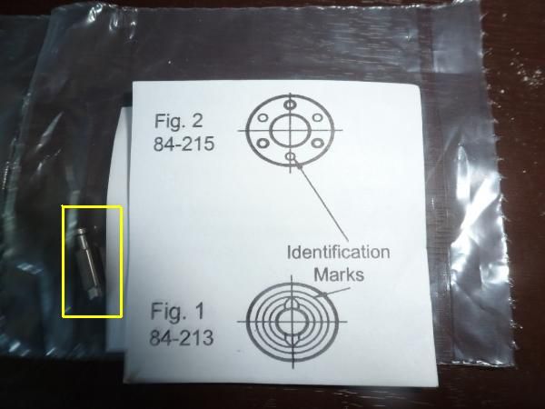

Ok I got the kit today, I put up picture of the carb and the parts, but I don't think all those rings are needed. I only see the seal for the bowl as being needed correct me if I am wrong.:NO NO NO:
I don't understand the instruction either or the diagrams given. I didn't see anything in the breakdown of the carb of a valve seat or retainer with ID marks. ... Plus I don't know which number relates to my carb.
Can you tell me what parts I am going to need. Is it just the valve for the float, the ring for the bowl and the gaskets is all I need? What's this about a retaining ring???

Hope I took the right shot and it is clear enough...
The number on the left is the float and the right the kit.

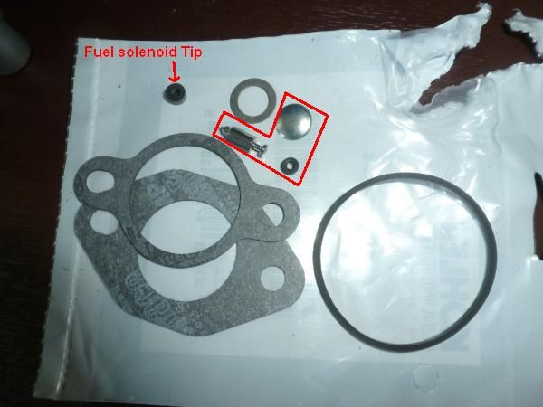

spirittoo,
Discard the parts in red box and install the new plunger seal on the tip of the solenoid, Use the new float assembly with the new needle valve in the separate bag (yellow) and you should be good to go.....
