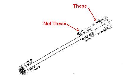

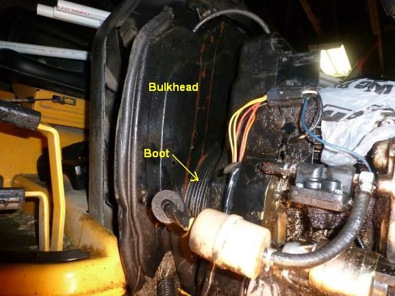

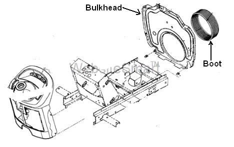

spirittoo,
31YTech;If you can borrow or rent a pressure washer that would work better.
The above is what you need to do, That engine and machine isn't clean enough to see what you need to for performing this job. It's hard to see fasteners that are caked with oily mud or covered over in grass.
All the wires shown in your pics are part of the engine wire harness, Unplugging the one main engine harness plug from the main tractor harness plug, And removing the large red battery cable from the starter should separate engine from tractor wiring.
The two drive shaft bolts are behind the air intake boot at the flywheel, You have to remove the screws holding the bulkhead in place, Lift up and move to one side then the driveshaft and coupler bolts can be seen;
Good Luck
