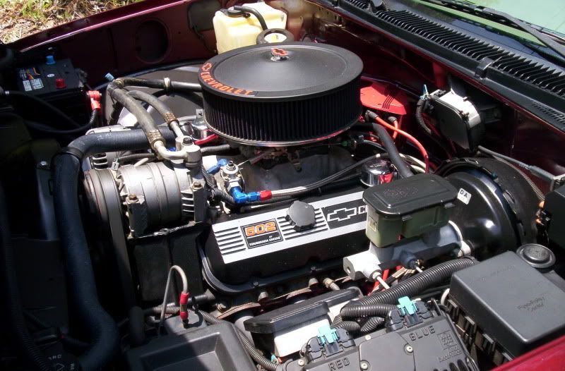

Here's a pic of my ole truck, A measly 725 hp at FW on the bottle.....
