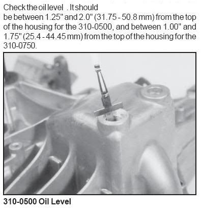

I have a Craftsman hydrostatic drive lawn tractor, model # 917.252711. Bought a new lawn tractor 4 years ago and stored my Craftsman in the shed. I went to move it the other day and it will not move, I see a big oil stain on the floor under the rear wheels. Someone told me the transaxle fluid leaked out from sitting so long, how do I put new transaxle fluid in? Thanks.....

I believe the only way to put fluid in that model is to remove the vent from the top of the unit and put it in there.

Hello grantiman,
As Mr Cheese mentioned, Through the vent hose/cap.....
Use 20W40 or 20W50 engine oil.
Go with 1.25" from the top.
Good Luck

If this model has the battery under the seat, take the battery out and then lift the battery box out and you can access it from there. If this has the gas tank under the seat, then at the back of the mower between the rear wheels is a black metal cover that has the place to mount attachments to. This can be removed by taking out 4 9/16" head bolts and you can access the tranny from there.

I put the oil in my transaxle, took about a half a quart, it still won't move forwards or backwards. It worked alright before I stored the lawn tractor, now after a few years of sitting it won't move, can't understand why. Any other idea's on what I should do next? Thanks......
