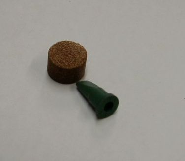

Sorry for the misleading info. This is what happens when the manufacturer has incorrect info in the parts break down. The fuel tank vent is under the carb adaptor you have to remove the carb & the adaptor plate there is a sinter bronze plug over a duck bill valve (one way as I said) same parts as for the oil tank but the parts breakdown only says one each which lead me to believe that the vent was in the cap
Before I pulled the carb I would empty the fuel tank & put a vacuum pump (hand operated) on the fuel hose if it won't hold a vacuum the vent is good or the fuel line is cracked.
AJ

Ok, so I removed the carb and base plate, and got to the vent. It has the sintered brass cap on it. So how do I remove it? Do you have to drill it out the brass cap to remove and once the cap is off how do you remove the vent?

drill a small hole in it (it isn't very thick) & turn a screw in & pull it out then you can just pick out the duckbill

Ok, drilled the hole and put in a screw. It ain't coming out. I put a pair of vise grips on my screw and tried to wiggle it back and forth, and it just bent the screw. I seems that there is a round boss there in the plastic is there anyway that the plastic over the top would keep it from coming out? Like it is pressed in from the bottom?

It is pressed in from the top never had one not just pop right out You might have to drill a larger hole & break it out.
It looks like this:

There was no bill there. If I put one in does it go bill side first?

Yes bill side into the tank so that air can get in but the gas won't come out.
