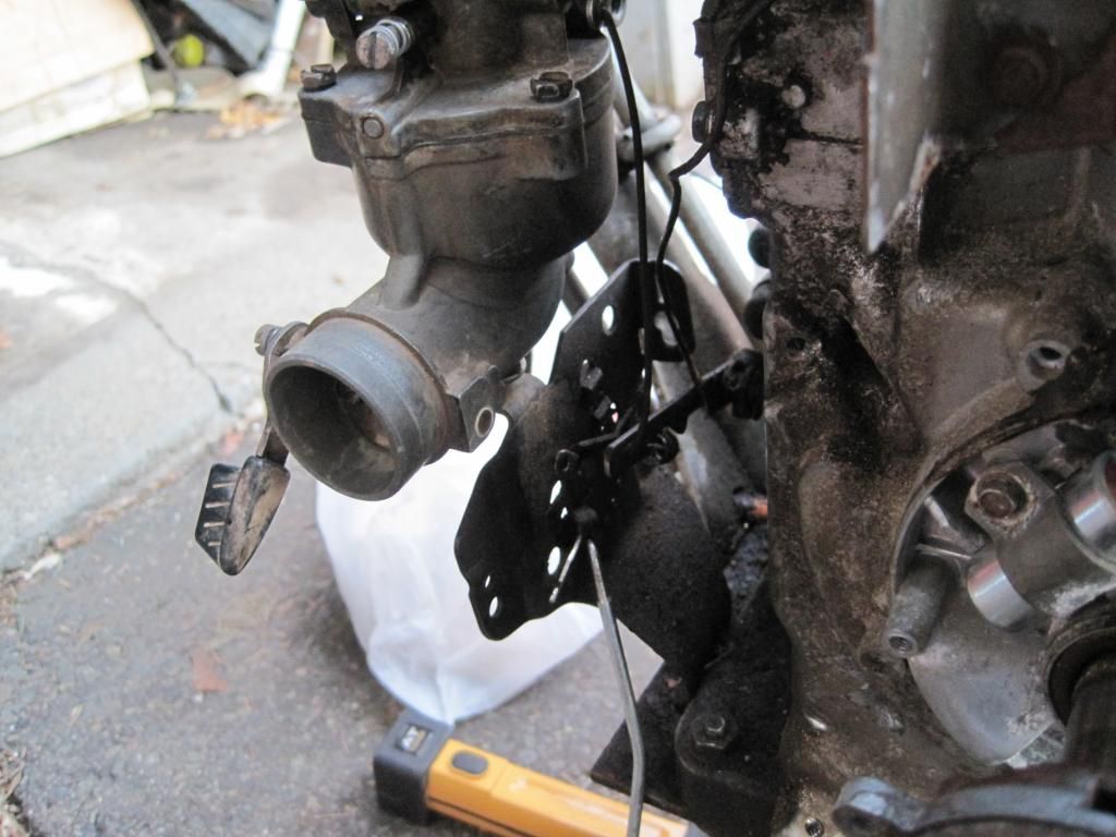

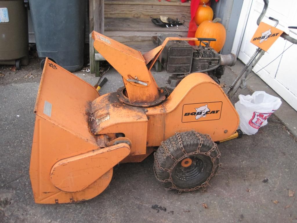

Hi everyone. I have recently acquired a Bobcat Snowblower. The engine was built in 79 so I assume the machine was manufactured the same year. The guy I bought it from found it in a barn. From what he told me, it had been sitting in there for quite some time. He bought it from the barn guy and decided to sell it. When I bought it he told me it had no spark. I've done points on many Briggs engines before so this was no problem for me. When I took off the flywheel to reveal the spark, I noticed that the plunger that sets the motion for the arm that touches the condensor was jammed and ceased. So I decided to leave it all in tact and install an electric ignition (magneto that bypasses the points alltogether) I gapped the magneto as close to the flywheel as possible without touching and put it all back together. Got a good clean spark.
The next bit that I tackled was the gas tank, fuel line and carb. Looks like gas sat in the tank while the machine sat in the barn for who knows how many years. Cleaned the gas tank out so there was no residue in it and took the carb off to be ultrasonic cleaned which has worked very well on other engines. Put it all back together and got nothing, not even a puff of smoke.
So I took off the original carb and put one from another Briggs engine I have. I have two Snowbird 262's and the carbs are almost identicle. Minor differences in the throttle linkages and the jet inside the carb (brass jet that threads inside the carb and can only be taken out when the high idle adjustment screw is taken out) This particular carb was leaky but the engine started up with it. Lots of white smoke at first. Could only get it running with full or almost full choke and for only about 30 seconds at a time at most.
Decided to try the original carb again. Recleaned it, new gaskets and set the adjustment screws 1.5 turns out each. Carb filled with gas but no dice. Put the leaking carb back on and could only get the engine to fire for about 10 seconds at a time. Got it to fire on full open choke however.
I decided to try one more carb. I have a running Snowbird 262 with a carb that is properly adjusted. So I decided to use that since this engine starts always on one pull even in the cold (not bad for an engine built in 62)
After putting that carb on the Bobcat, I got nothing out of the engine. I know I am getting gas and I have spark but I simply don't get it. The engine only seems to want to run with the carb that is leaking (same exact carb as the Snowbird carb). It won't run with the tightly sealed carburetors that do not leak. The leaking carb gave me an exhaust backfire once (small flame) which I believe means too much gas was being dumped into the cylinder and the fuel was still burning when the gas was being exhausted (correct me if that is wrong). I checked the valves and piston and all are working as they should.
I might try today to put the original Bobcat carburetor on the running Snowbird and see if it works. In the meantime, can anyone here figure this out? I am completely stumped. I'm thinking maybe the spark is weak but I made sure that I got the correct replacement part for the electric ignition. Any help is greatly appreciated. I attached pictures to give you an idea of what I am working with. I will supply model #'s if needed.

I see you had the flywheel off. That fact, and the mention of a backfire says that you might want to go back and check that flywheel key. If it wasn't torqued well enough or if the crankshaft had oil or grease on it at all, it may be sheared.

Hi Cheese. Thanks for the response. I was actually reading another thread on this site before I decided to post about my engine. Thread can be found here: http://www.doityourself.com/forum/ou...has-spark.html
So I did a quick check of the key already and it looked okay to me. Should I take the flywheel off to check it though? I made sure to crank the flywheel back on when I put it all back together. I got a big nut that fits on the shaft and tightened it against the flywheel while a breaker bar until I couldn't crank it any further.

It looks like yours has a cranking ratchet, not a nut. Did you put a nut on in place of it?
I thought you were getting it to fire up on one carb a little, but barely. A flooding carb will add more gas to the fuel air mix and possibly help it run with late timing (sheared key). You said the carb that runs fine on one engine won't even start this one, right? I'm still thinking sheared key. Did you install a new plug?

I did use the nut only to tighten the flywheel onto the shaft. I then put the starter clutch back in its place. Sorry for the confusion. I realize this whole thread is probably a little confusing!
You are correct, I did get it to fire on one carb. I got it running for maybe 30 seconds at a time with almost a full choke. But what you are saying makes sense. If I am still getting spark with a sheared key, the carb dumping too much gas into the engine might still get it to fire. Hence why the two good carbs aren't doing anything for it. Okay, I will have to check the key again then. I'll take the flywheel off this time to check it.
Do you think that putting in the electric ignition may have messed this up? Say if the unit is no good but is still producing a spark; just a weak spark. Or perhaps I didn't gap it correctly? Every source I have checked has said to place a business card between the flywheel and the magneto to set the gap. Thanks for the help!

You have to get the clutch that tight. Tightening it with then nut doesn't do anything because you took the nut back off. You didn't put oil or grease on the shaft or flywheel bore did you?

No I did not. And I did get the clutch that tight when I reinstalled it. I've done a lot of points on Briggs engines so I am fairly familiar with the process of disassembling and reassembling. I have never bypassed the points however, this was my first. Which is why I am thinking that the error would lie in the installation of that. But I still have to recheck the key. Which means taking the flywheel off. I checked it last week after reading that thread I posted and it looked fine, completely in tact. Of course maybe it did somehow shear and I can't tell because it is sandwiched in that small space.
But just to set the above straight, I did crank on the starter clutch and I did not apply any grease/oil anywhere near the shaft of the flywheel.

Okay... Just trying to cover the bases. I still want to put reservations on the flywheel key, mainly because it's what I would check from here, even if I just saw it during the ignition conversion. How about a new plug... did you try that? If so, and the key is intact, then what about compression? I don't recall you mentioning that it is in acceptable range. Since your ignition is working, I doubt that the armature air gap is a problem, but you should have it gapped at .010". Line the flywheel magnets to the coil, put a business card between them if you don't have brass feeler gauges, and let the magnet pull the coil to it and tighten the screws, then roll the card out and it will be gapped properly. The shavings from the starter are most likely because of the wrong gear on the starter. It should have a nylon gear on it.

Put it back together last week. Reset the gap anyways. Gave it a pull and it started. So I tried working the choke and throttle to see if I could get it running but nothing. Eventually it just died and wouldn't start when I pulled. The good news however is that it started with one of the good carbs. That hasn't happened before. I also put a newer spark plug on it (J19LM, same as the one that was on there).
I am going to try today putting the original carb on. The original carb has a jet with 4 holes in it and the 2 other carbs have a jet with only two holes in it. But now that I got it running with 2 of the 3 carbs I have, I might as well see if it'll run with the original.

Yes. The carb that is on it is from a Snowbird built in 1962. The Bob-cat was built in the late 70's, engine was built in 78. Like I said, there are minor differences in the carbs. The throttle assembly which is just a different linkage and then the jet gas nozzle inside the carb. The Bobcat's carb has a nozzle with 4 holes in it, the Snowbird carb has a nozzle with 2 holes in it. Both Snowbird carbs made the engine fire as I've said before. The Bobcat carb seems to be dead, I get nothing out of it.
But I'm thinking that maybe these minor carb differences are the cause of the issues. Snowbirds have a 6hp Briggs and the Bobcat has an 8hp. I do however have an 8hp Gilson that was built in 79 with a Briggs. Only one year newer than the Bobcat. Same engines so I will try the carb from the Gilson to see if it makes a difference at all.

Late response to this but I tried to carb from the Gilson. Unfortunately, I could not get the carb apart to clean it because the jet or gas nozzle would not come out and it is only a brass screw. It didn't start. And the Gilson didn't start with the original carburetor from the Bobcat. So I'm thinking it is a carb issue.
I am looking at a brand new carb right now for $58. It is a lot but will be worth it if the carb is indeed the issue. What else should I check before buying the carb? Keeping in mind it did run with the carb from the 6hp SnowBird.

First carb used: Original carb from the machine. It was cleaned and put into an ultra sonic for deep cleaing. Never made the engine run.
Second carb: From a 6hp Snowbird built in 1962. Different from the original carb in that the jet/gas nozzle and bottom adjustment screw were slightly diff. sizes and style. Engine ran on this carb for about 30 seconds at a time on full choke.
Third carb: From my other 6hp Snowbird. Same exact machine as the previous, same exact carb as well. Engine ran for only about 10 or so seconds before not being able to run at all. Mostly got backfires from this carb (also got backfires from the previous carb)
Fourth carb: From an 8hp Gilson. One year newer than the Bobcat (1979). Same carb. However, this carb was fairly gummed up. The plan was to rebuild it but unfortunately I could not get it apart because the jet/gas nozzle screw would not come out. Carb went onto the machine as was and did not get the engine to fire.
I placed the Bobcat carb onto the Gilson and the Gilson did not fire up.
Flyhweel key not sheared, compression check was good. Valves and pistons moving freely as they should. New spark plug, clean gas tank, fuel line and removed old gas filter (straight gas line now, no filter). Gas comes out freely and cleanly. Carbs checked for gas each attempt and all were filled. Ignition coil/magneto from a used engine purchased on Ebay. Checked the spark with a spark checker and it is indeed getting good clean spark.

Haven't tried that. I've noticed a lot of gas coming from the carb while it starts and stops, mainly from the choke. Although the carbs from the 6hp and 8hp briggs are the same size, I think they are somehow different internally and that is the cause of the crappy running with the 6hp carbs on the 8hp engine. I bought the new carb a few days ago. Should be here by Friday. Hopefully it all goes well and works because I heard that MA is getting another foot of snow this weekend.

Couldn't get it to run with the brand new carb. It tried to and wanted to but didn't. I took the new carb off and put it on the Gilson. Started up first pull. So carburetor isn't the issue. Could it be spark? Maybe the electric ignition that I got for it off ebay was bad?
#34
The coil on these can be flipped over and installed upside down. Worth a look I guess, but I don't recall an upside down coil ever sparking at all.
